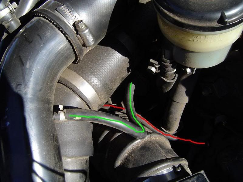

Anyway I just want to confirm how it connects. I took a pic of the lines where my solenoid USED to be. I have one line that leads no where and has a screw in the end (highlighted red). From reading, it used to be connected to the solenoid yes? And is no longer needed?
Do I cut the line I highlighted green and fit one end each to the 2 joins of the turbotech? Or am I an idiot and have the wrong line completely?

Okay so the green line in my pic is the one from the intercooler pipe and the red one with the screw in it, i remove the screw and attach it the other bit on the turbotech?

okay
check where the red one goes.. if its on the old boost solonoid then leave it blocked.
Also dont unscrew it at all. leave it. the green one with the clamp you can see is the intercooler pipe. cut that hose and put it inbetween the one hose.
if you get what i mean.. that hose you got going to the intercooler pipe (green) should be going to the wastegate actuator. double check that first. if it is then CUT the green hose and put the turbo tech so they kinda join up again but using my diagram to make sure the right one goes to the boost pipe.
ive confused you? ok here is a better set of instructions.
Forget the red one exists. Leave it there and forget it..
Cut the green line with cutters 4 cm's down the line. Put the hose thats been cut commin from the boost pipe onto the turbotech diagram side that says "intercooler pipe" put the other hose thats been cut on the other side of the controller.
Thats it :worship:
Ok.
The red one (with the screw) im pretty sure USED to goto the boost solenoid which is gone. (Previous owner removed it)
If the green one runs from the IC pipe to the actuator, I simply cut it in half and fit the turbotech inbetween so its rejoined. Yes? Just gotta follow your diagram and make sure I attach the right ends to the turbotech. Got it. If im understanding you correctly.
