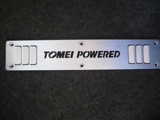

Custom Vented Coilpacks Cover
This is what the look like normally. Except we only got the 2 doors locally
