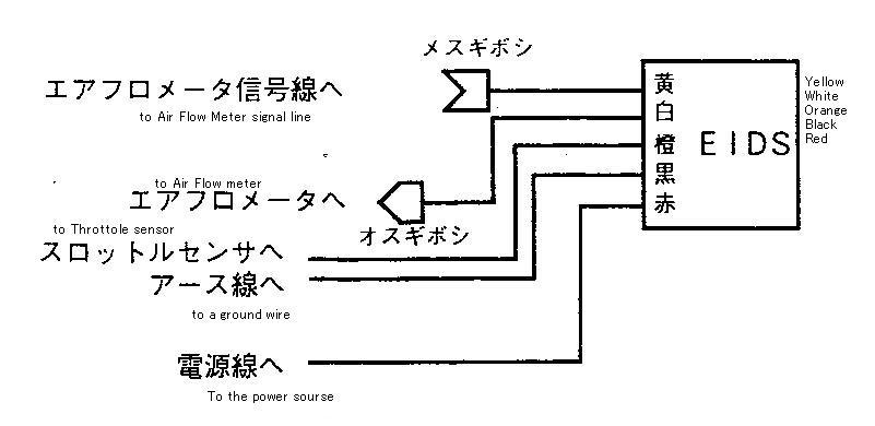

Installed my HKS EIDS but think I've put the MAF wire around the wrong way, interpreted it off the actual JAP instructions as YELLOW wire to the wiring loom and the WHITE wire to the ECU but I think it may be incorrect as I am not getting miss fire off boost
Can anyone please clarify?
Thanks
