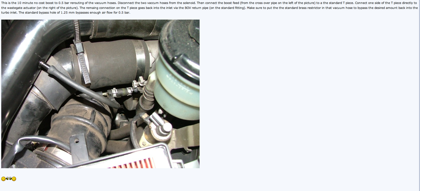

Hi,
Ive wired up the constant ground which is now successfully running the high boost mode permanently. I also wired into this a switch under the bonnet. Sure makes a difference to the feel of the car around town. Definately more usable poke.
Anyone had any issues running it this way for long periods (solenoid burning out etc), or anything else of interest?
Just curious.
Cheers,
Matt
