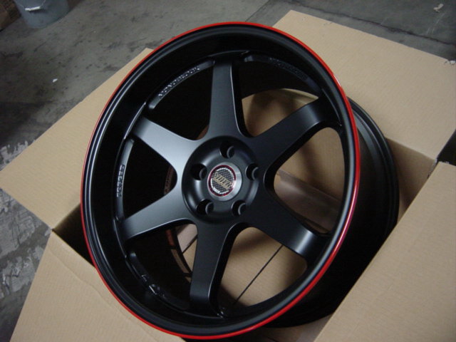

Te37 Time Attack Black W/red Stripe
You are selling this? I have never bought something from marketplace...i dont know if i trust that enough. And the price is little bit "too" good...
