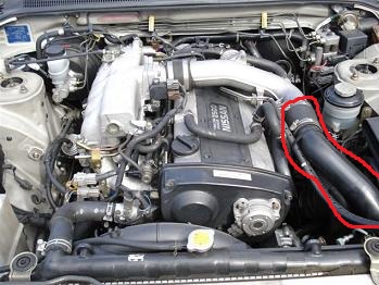

After using a protractor for an actually accurate assessment of what is required, and by NOT using my uncalibrated eyeball I worked out I need a 25° silicone bend from the TB ro the MAF, but, my choice was either a 30° or a 23° (23° is a weird spec), so I grabbed the 23° one from Raceworks I also grabbed 1mtr of 3" straight from Just Jap, I needed 350mm, but they only had 300mm, or 1mtr lengths....meh Also ordered a 1/2" hose bulkhead fitting from fleabay, this has a smoothish mushroom looking head (they are designed for below the water line of boats) that will fit inside the bend, the hose bit and threaded bit looks to long, but nothing that a hacksaw cannot fix if required, the hose will then just get jamed on the threaded bit up to the retaining nut Fingers crossed and the unsightly amount of hose clamps will be reduced down to 4 once all the parts arrive
