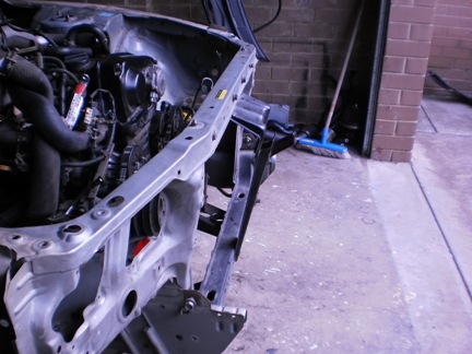

Finally have an update on this Rack came in this week so I did a test fit. You do need the S chassis bushings since the rack is 5mm thinner than the R33 rack. The main issue I foresaw and ran into was one of the hardlines not lining up properly with there it's meant to on the rack. After some gentle coercing and bending very slightly, I managed to get it to fit without any kinks and keeping the hardline pretty much in all of the factory mounting positions. I did have to unbolt all of the soft mounts to move the line around so I could snake it out and bend it safely but it looks good to me for now. I'll update when the rack is fully bolted in and functioning.
