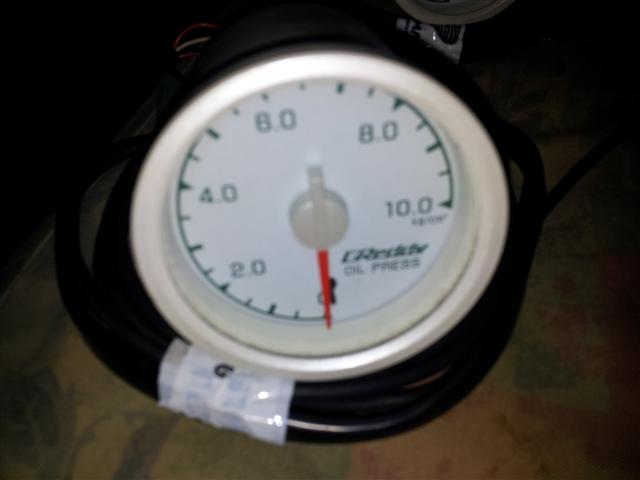

Greddy 60Mm Gauges X 4
Yea that’s why I said ima test them with multimeter and see the reads.
