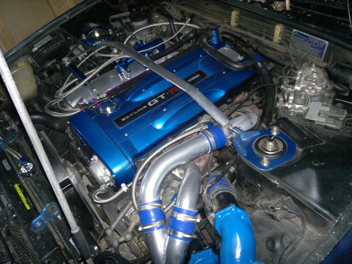

You think its the AFM? I know its a common issues on R32s. I find it coincidental how this issue raised right after cleaning the fuel system. As everything except the fuel system was fine before. I tried running it with the IACV unplugged but did not notice a difference and still stalled. However, the RPM gauge is not in the cluster right now, so I will need to connect the laptop again and use Nistune to check the RPM. I will check this weekend. -
