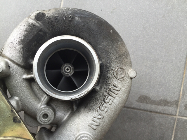

If there's enough meat in the housing where you want to put the M12 adapter, then do it, but be aware that if/when you f**k that up you'll probably be repairing it before doing anything else. I'd just drill it out and tap ina 1/4" thread. No need for rocket surgery when the next most obvious thing will do. You could throw a 1/4 x 1/8 bush in there and use the same fitting you intended to use.

Tried to make 1/8npt threads into compressor house of the turbo for my EBC. Threads got fu#ked and ended up with and elongated hole, so I do have good amount and nice threads 90% of the hole but 10% I only had 1-2threads there and rest of it is flush on that side of the hole.. So my idea is to do M12 x 1.25 to AN4 with braided lines instead of 1/8npt to 4mm vacuum silicone hose. and hopefully get a better thread. M12 is quite big and AN4 is a little bit bigger than 4mm (4.9mm inner diameter braided PTFE hose). but this should work. Thoughts? Otherwise I will weld and adapter onto the turbo.
