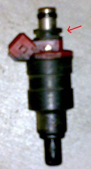

I just pulled my injectors out of my RB20DET cos a couple had leaky O-rings. Now i've notived that underneath the o-ring there's another rubber seal looking thingy (see picture). I'm wondering if these need to be replaced as well as a couple of them seem pretty shagged.
Cheers guys, Simon.

You wouldnt have had this problem if you practiced safe sex with your injectors :yes:
PSYMON having FRESHLY gone through this... i suggest the following
take your injectors to an injector specialist, get them cleaned up and reconditioned, this shouldn't cost too much, around about the $100 mark for all 6
this is a must while you've got them out, think how freaking old they are, think of all the mineral deposits and other shit going through them, you owe it to your injectors to service them while they're out of the car
and yes, those shagged rings are shagged, no two ways about it, best to get it done while they're out, save you having to take em out again
but the final most IMPORTANT THING
ALWAYS GET YOUR O RINGS FROM A NISSAN DEALER OR A WORKSHOP THAT GUARANTEES GENUINE NISSAN PARTS
aftermarket DO NOT FIT and petrol will be pissing out all over your inlet manifold... DO NOT use a/m parts for this.
it's worth it dude... i paid $30 when i swapped my injectors over for the lower O rings the complete set must be worth $70
think about what they do though man, understand that they stop fuel leaking all over your inlet manifold and thus blowing your car up
