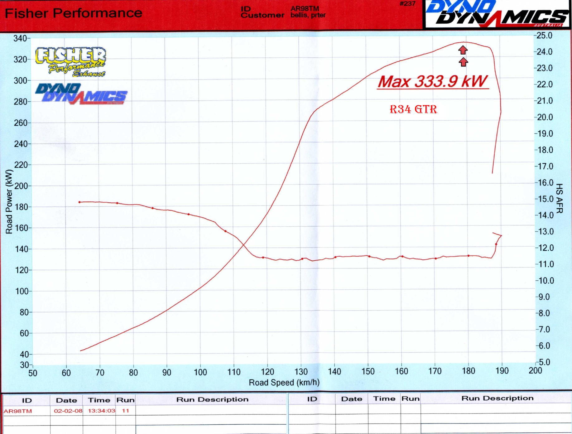

You very likely need to get it on a dyno and tune it. My assumption is, you've got an RB25DET tune in it, which has a different manifold, different injectors, and different cams as a minimum. What O2 sensor are you running? When you say it runs extremely rich from idle all the way to redline, is this just free revving it you see that?
