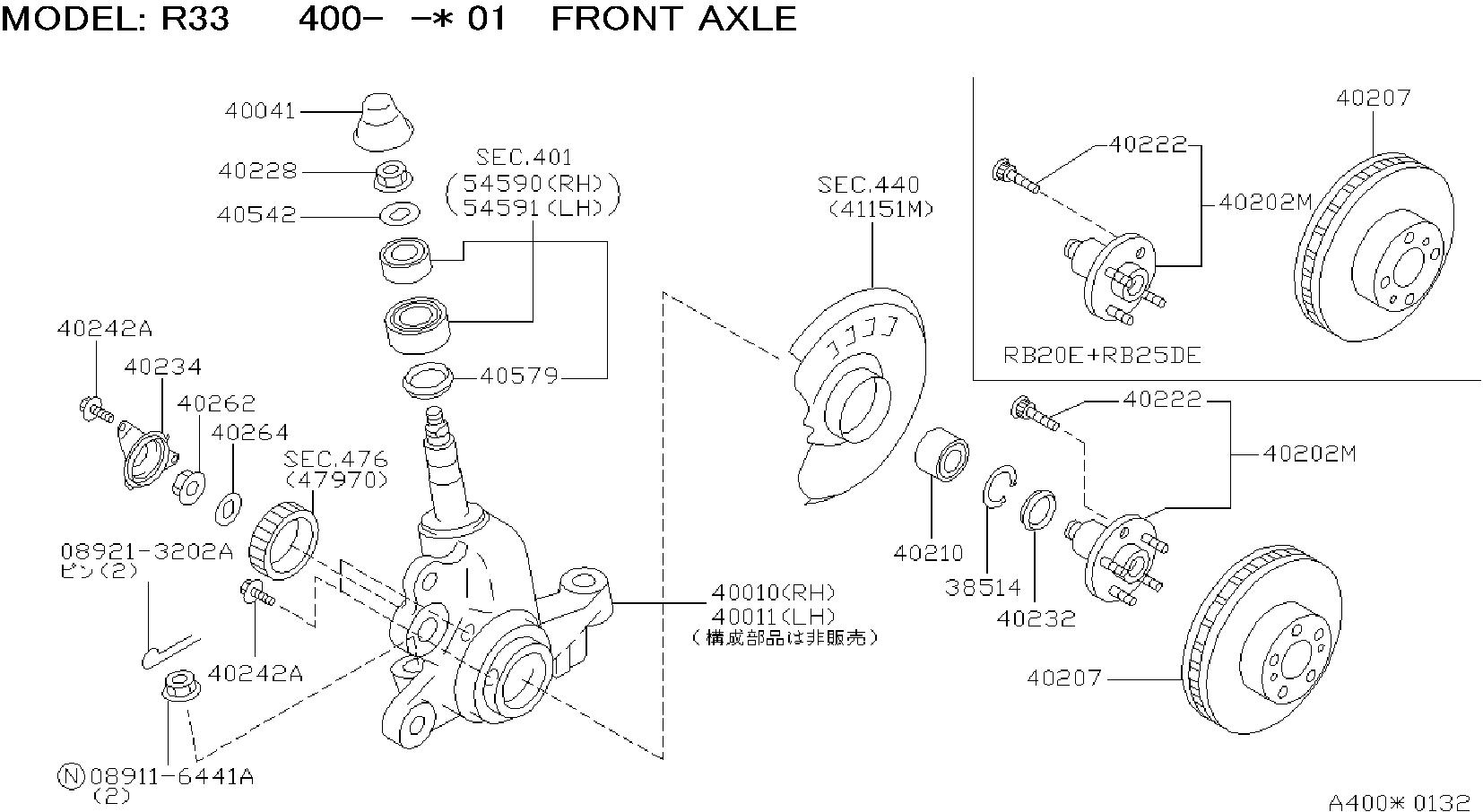

i need to change my front drivers side bearing, i took the wheel off today but there seems to be a steel cover sort of thing over the front of where the bearing is
how do i access the bearings? do u need to take the caliper and disc off?

You really need to take the entire hub assy off the lca and upper support.
makes life easier.
i attached a pull apart diagram, the centre are usually a press fit, but im used to 32's.
