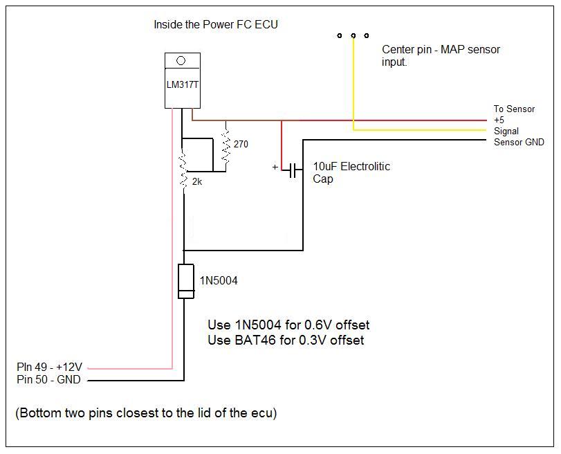

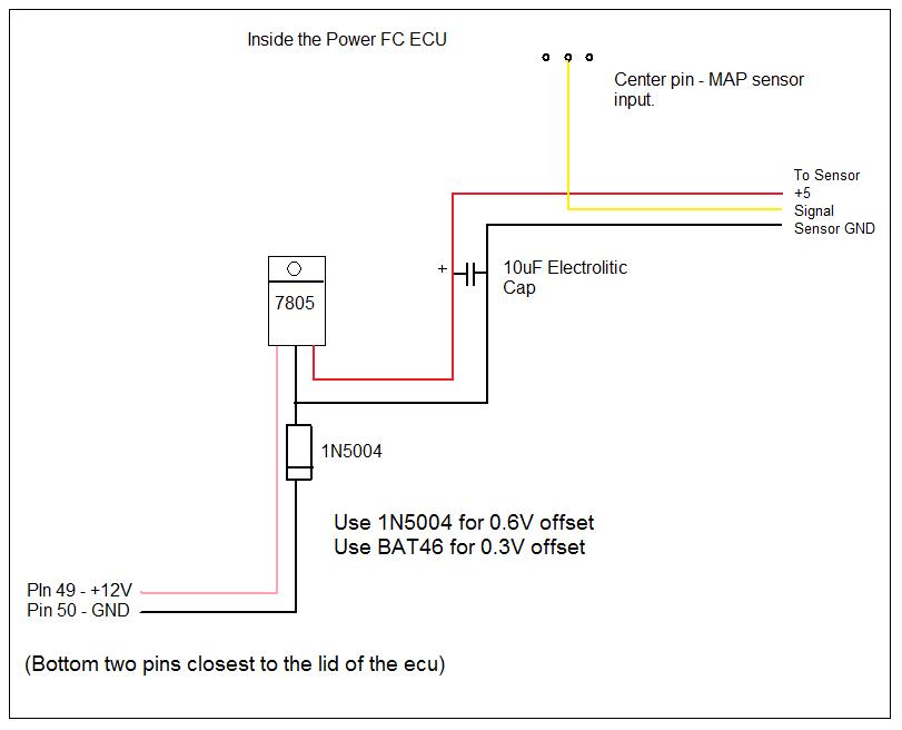

This was the case with the GM 3 bar sensor, so what I came up with is two circuits that can be used to correct the offset, or the scale and offset of the FC’s boost input. This allows the use of cheap and common sensors to interface properly for logging or boost control.

This circuit uses a 7805 (very cheap and common voltage regulation IC) and a 1N5004 diode (also cheap), to make a 5 volt regulated power supply for the MAP sensor. The diode is used to offset the sensor ground voltage by 0.6V, so that the inaccuracy is corrected. This calibrated the GM 3 Bar map sensor to the FC accurately, and presented an offset inaccuracy of 0.05kg/cm. The scales of the GM sensor and the normally used Apexi sensor must be pretty close (though I only tested to 1 bar).
This cost me $1.90 in parts, plus the sensor and heat shrink I already had. I assembled the whole circuit mounted off the 7805 IC, and then wrapped the whole lot in heat shrink. The IC does not need to be mounted on a heat sync as the map sensor will not draw more than about 50-75mA. The circuit can do 150mA before the component needs the be thermally mounted.

This circuit is a variation on circuit 1, using a LM317T variable output IC. Same principal apples for offsetting the voltage, but a 2K carbon variable resistor is used to allow the voltage on the MAP sensor to be under or over driven. Under driving the sensor will allow the hand controller to display a lower boost level, over driving it, the opposite.
EXTREME CARE MUST BE TAKEN IF YOU DO THIS… or you will let the smoke out of your map sensor, and potentially damage the FC map sensor input, or even toast your ECU completely. I would not over drive the sensor by more than 6v if it is an electronic type sensor (like the GM sensors). Also, take into consideration the boost levels you are running.
Running to 1.5 bar on a 3 bar sensor means the output voltage of the sensor will be about 4 volts, and is still very safe for the ecu.
Running the same boost level on a 5 bar sensor will have a much lower output voltage, as the sensors internal diaphram will me moving less for the given pressure. Also, running a 5 bar sensor if you only plan to run 1.5 bar is not a good idea, because while you can correct the scale and offset error with the circuits, the 5 bar sensor will give you less resolution (accuracy) than the 3 bar would.

Simple. The regulator IC’s provide a constant 5 volt (or corrected 5V for the LM317 circuit), with an offset ground signal. By using the 0.6 voltage drop or 0.3 voltage drop of common diodes you can offset the sensor’s output voltage. This corrected voltage is then used by the Power FC to produce and display the correct boost/vac levels.
Using no diodes would be the same as running the sensor off the regulated power that is suppled from the MAP sensor plug on the ECU.
Using a single BAT46 diode corrects by 0.3 volts.
Using a single 1N5004 diode corrects by 0.6 volts.
Running the diodes in series would correct by 0.9V etc…
