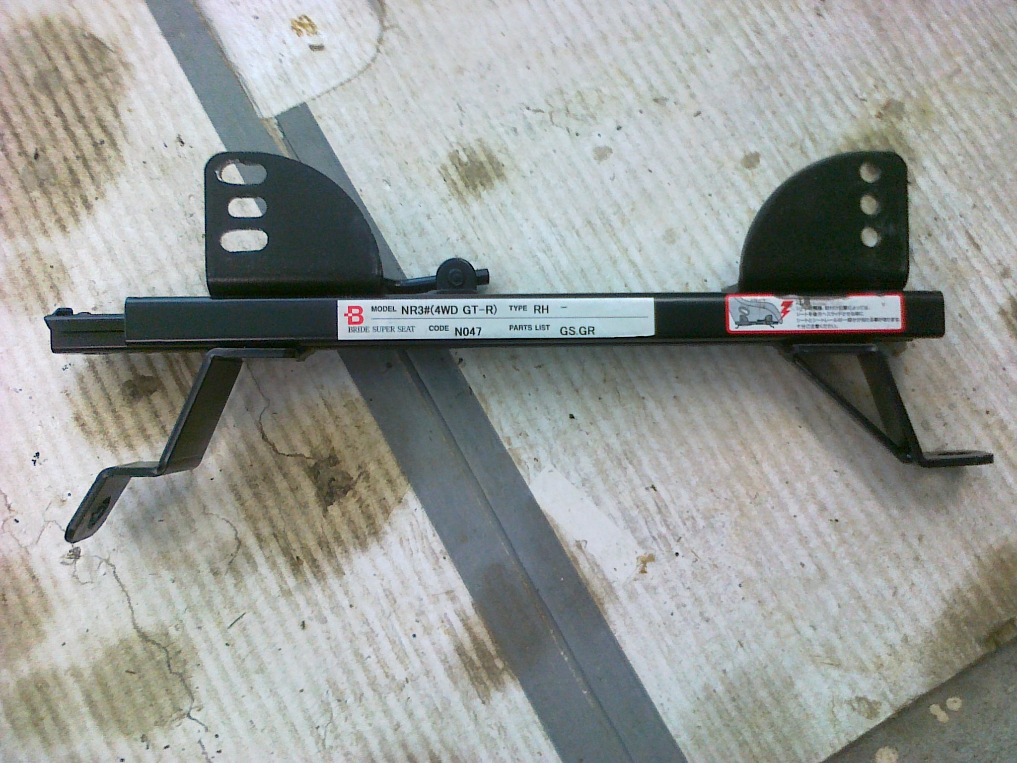

Selling side mount bride seat rails to suit 32,33 GTR and GTSt and R34 GTR. (Not GTT)
There is sliding adjustment on both sides.
(I only have a pic of one side though.)
