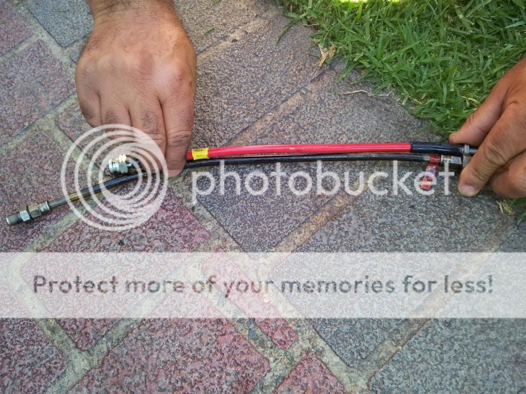

Have a look at this picture ill send you and you will see the black line is the old one coming off the front wheel but the red one is the new set which are WAY to short. Now theve send 2 short ones and 2 long ones but the LONG ones dont have the same fittings as my old braided brake lines that go on the fronts. I am so confused right now because how can they send the wrong ones 2 times!! I was wondering if you have any pictures of your HEL braided lines u purchased so i can compare them to mine.
This is a picture of what i was talking about

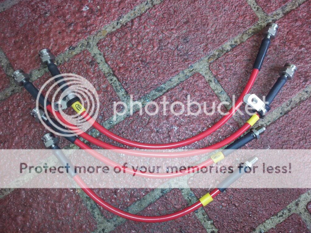

and Here is a picture of the Entire set but take notice to the fittings, the long ones only have Female Ends on them.

IIRC my HEL braided lines were the same, its meant to be fixed to the metal line as it only replaced the rubber part
I'll try and take pic of mine later today to confirm for you, memory bit hazy but i recall it throwing me off as well
Thanks man if you could take pics that wud be great !! :)
Check your PM, they are correct, i got my HEL lines from Import Monster and they were identical and went straight on after opening the thin clip holes on the front lines.
Thanks man ! yeah i've had a look , hopefully i get this shit fixed asap :)
