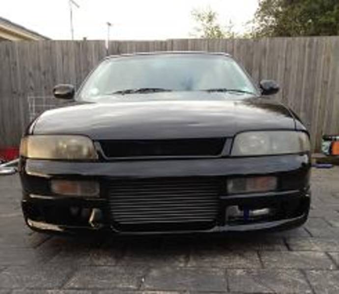

Guys since i bought r33 gts25t coupe 1994 automatic a/t(manual swap 350z gearbox) all i got is problems, always problems. Lets start with that when i turn key into ignition(ON) fuel pump doesnt always works. Sometimes i have to turn key twice Off/on/off/on until it primes. Its new, dw300 - 340lph. My gearbox broke so i did gearbox swap, install different intake manifold, injectors and i take pipes. Car was sitting in garage for more than half a year. I did assembly all not that long ago and when i turn ignition cant hear prime. All of sudden it stopped working. Theres many videos on YouTube how to make relay mod on r33 straight from battery so i did and it doesnt work! 😰 30 - battery positive 87 - positive from fuel pump to relay 85, 86 - one of two wires from original fuel pump wires(light blue, grey) and it didn’t work. so I check on ignition and took original BLUE relays wires from trunk, next to fuses. (I believe it’s IGN+ and ECU pin 18. it didn’t work… tried connecting (IGN+ from og relay) and (ECU 104 from 1of4 FPCM wires) to my new relay 85/86 and it didn’t work. I unplug FPCM. Didn’t work. im thinking what’s wrong fuel pump is working, if I leave IGN+ on 85 and 86 straight to ground it works but it’s just nonstop. Since it getting constant 12v after key in ON. light blue wire gives me 6-8v. so how this should be connected? What causing ECU not giving — on pin? Or I did sth wrong and that’s why it doesn’t work? I need negative signal on ECU that control fuel pump. What this should be?
