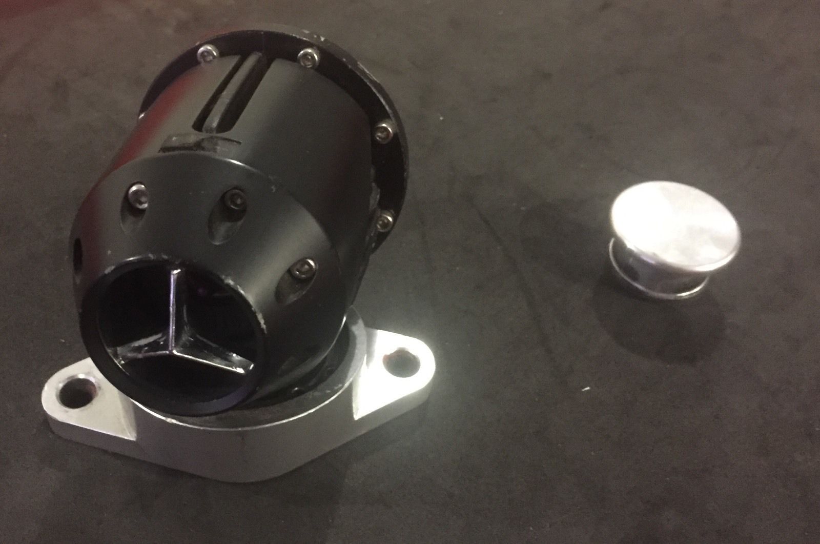

HKS BOV with Adaptor & Turbosmart Plug, R32, R33 R34
