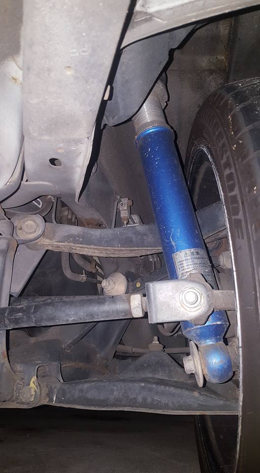

First was coilovers and rear toe arms for me, funny story this one! So I was having major problems with my hicas (surprised I know!) when I bought the car (twas a lemon!). So I ended up instead of putting a lock back on the rack, I unbolted everything, and installed adjustable toe arms. So in the process of removing the rack ends from the rear stub axles, I employed the technique of smashing the lower part of the stub axle with a hammer to break loose the rack ends. Well, this is where it becomes interesting. I had noticed while driving the suspension was rather 'bouncy' and I now know why. While hammering the right side, I noticed that the bottom of the left rear shock was dripping, with water. Yes, I still don't know how but there was a crack in the bottom of the shock canister, and water was coming out. SO, I carried on and started smacking the left side. A short while later I inspected the right side and it too had started leaking, but it was oil and from the top of the shock. Talk about hard luck!!! To top it off, I had to end up using a machine press to get the bushes out of the stub axles to make room for the new style of the toe arms. Anyways, I got the toe arms in. I got the coilovers in and happy, days rock solid.

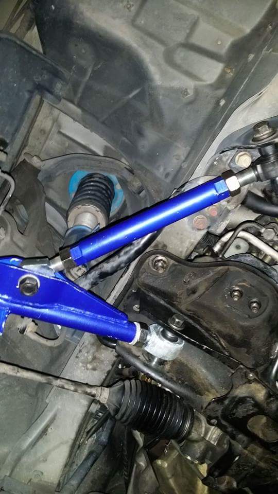

Third was more suspension, but in the front this time. Now, when I bought this car it was cheap. And for reason! Stupid thing was in an accident many moons ago and written off, but someone cared enough to put it back on the road and do the repairs. But little ol' me, has been left with mess of warped/twisted/bent suspension and chassis components. So, I bought some adjustable lower control arms with castor adjustment, and also a slightly less bent subframe. Alas, I was young, inexperienced with the Japanese monster. And there was much fun to be had with trying to match up the subframe and the lovely bolts that are for some reason, on springs in the chassis rails. A little bit of modifying, swearing and lots of alcohol later... Finally managed to pry in the subframe (with elongated holes, dodgy much). And once again, because of the twist in the chassis, the lower control arms were just as fun trying to fit them in...

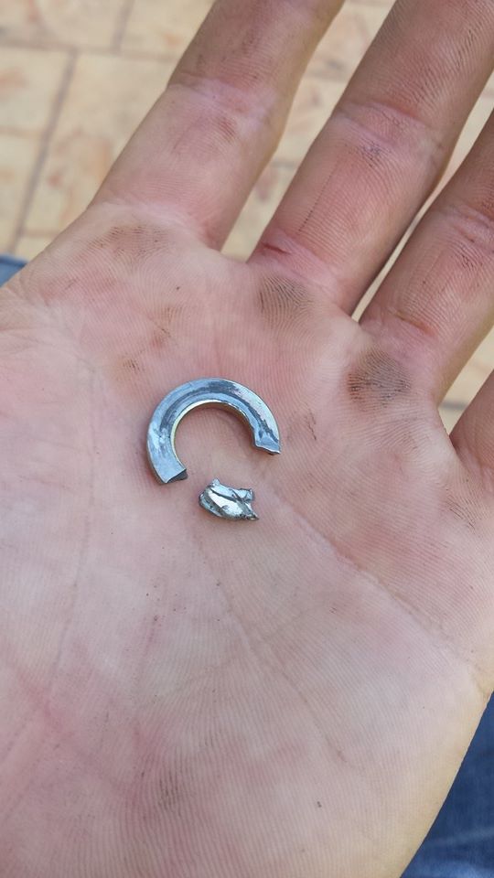

Fourth. So this next one isn't really an upgrade, but it kinda is, because I don't have photos of it sadly. BUT! It is a good story and rather interesting. So, I was washing my car and doing all that stuff, and went to move it into the shade to dry it. Dried it off all nice and pretty like, and then went to move it again but it wouldn't start. The battery wasn't dead, but there was no turning over of the motor. So I started to think maybe, the starter motor had stopped in a dead spot (im sorry I don't know the term for it). So started whacking the starter and tried at the same time, and still nothing. Tried to roll start it and every time I let the clutch out, the rear wheels would skid and not roll... So I thought maybe the starter was stuck/seized. So got it towed home (as I was at work). And then started to pull the starter out. Now, I ran out of time day 1 to do so and then started freaking out that the motor had seized (completely illogical I know). Pulled the starter out, and found this little piece of metal fell out. Bench tested the starter, all ok. Turned the motor over, all ok. So everything was good? Put it all back together and started the car, first time! So what stopped the car? A small piece of metal. I believe it was stuck between the starter and the flywheel (but who knows exactly). I later found out when I replaced my clutch (no photos sorry), that the washer for my pivot ball was broken. Lone behold, the same colour, same thickness, same curvature, it was the missing piece of my washer.

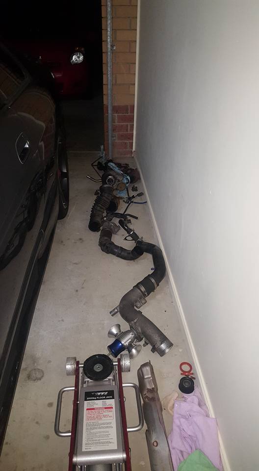

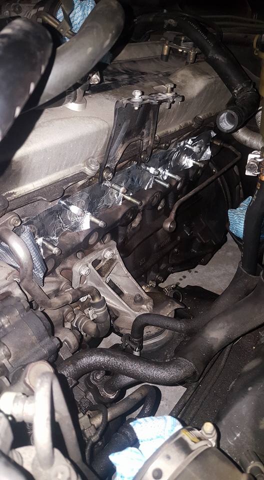

Sixth is what I am currently doing now. This is the start of some minorish engine work. So, end game at the moment is to get the car back on the road with around 400hp. But to do that, one must spend ones hard earned cash on things such as engine parts. So some things are off and out to be worked on and replaced. As you will see in the very last photos, the front bar is off and headlights out, intake piping, airbox, charcoal canister, turbo and exhaust manifold. Plans are at this stage, turbo, dump to suit, waste gate if needed, injectors, fuel pump(maybe an external), surge tank(maybe?), intake manifold, coilpacks, cam gears, cam shafts and computer. Oh did I mention I got a dirty 30 block xD. I don't know if Im going to use it yet, still tossing up the idea.
