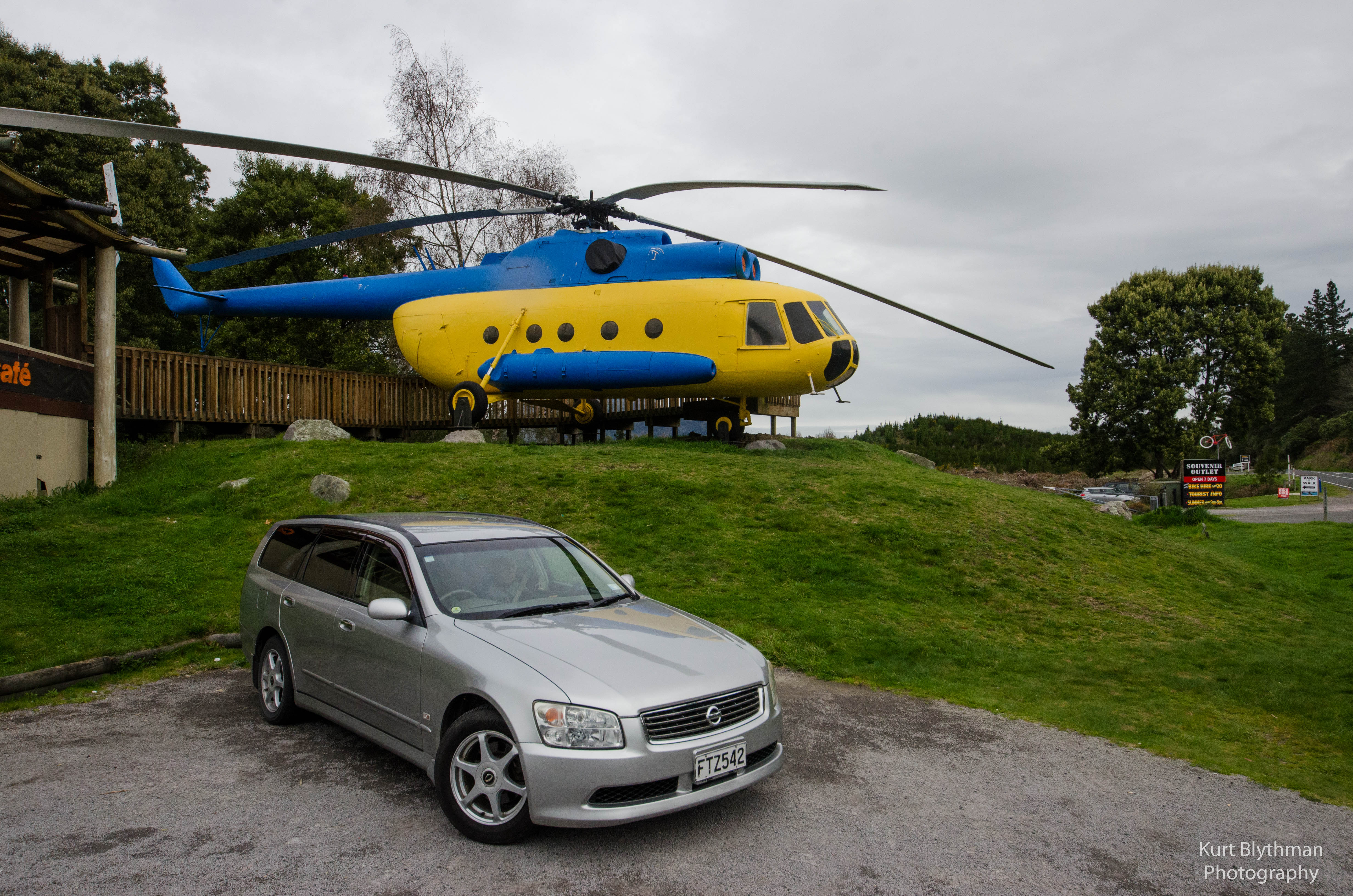

Oh here's a picture of it too, just cause no one likes to look at topics with lots of text and no images.
