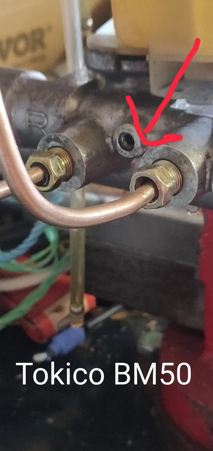

My Tokico BM50 Brake master cylinder has a leak from the hole between the two outlets (M10x1) for brake pipes, I have attached a photo.
Can anyone tell me what that hole is and what has failed to allow brake fluid to escape from it, I have looked on line and asked questions on UK forums but can not find the answer, if anyone can enlighten me I would be most grateful.

I don't get in here much anymore but I can help you with this.   The hole is a vent (air relief) for the brake proportioning valve, which is built into the master cylinder.
The bad news is that if brake fluid is leaking from that hole then it's getting past the proportioning valve seals.   The really bad news is that no spare parts are available for the proportioning valve either from Nissan or after market.     It's a bit of a PITA getting the proportioning valve out of the master cylinder body anyway but, fortunately, leaks from that area are rare in my experience.
BTW, if those are copper (as such) brake lines you should get rid of them.    Bundy (steel) tube is a far better choice (and legal  in Australia - if that's where you are).

Thank you very much for your reply, you seem to be the only person on the net who has come up with a definitive answer for which I am grateful.
The "Leak" was more by way of wet bubbles when the pedal was depressed hard by a buddy while trying to gey a decent pedal when bleeding the system having fitted the rebuilt BM50 back in the car, which now makes perfect sense.
A bit of a shame having just rebuilt my BM50, I did not touch the proportioning valve side of things, the BM50 was leaking from the primary piston seal and fluid was running down the the Brake booster hence the need to rebuild, I had never noticed any fluid leaking from that hole previously it only started when I refitted it to the car.
The brake lines in the photo are "Kunifer" which is a Copper/Nickel alloy brake pipe, but are only the ones I use to bench bleed Master cylinders, they are perfectly legal to use on vehicles here in the UK, however the lines on the car are PVF coated steel.
Thanks again for clearing this up for me, a purchase of a new BMC appears to be on the cards, I have been looking at various options in case my BM50 was not repairable and have looked at the HFM BM57 which I understand is manufactured in Australia.
