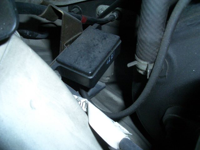

hmm ok, so i got home and had a look under the bonnet and see that the line coming from the plenum is going to a little box with the same sort of plug as indicated in the manual (link above)
this box:gif.gif
can i just plug my gauge into this? or is this leading to the ecu or something?
found out it's actually the MAP sensor and have had one person tell me its fine to plug straight into that, another saying it won't be suitable for an aftermarket gauge....

ok.....so now i'm trying to work out which wires on the map sensor correspond to the wires for my gauge.
anybody know what each of the wires from the map sensor are?
white:
greenish blue:
red:
or anyone know if the wires that connect an apexi boost gauge to a MAP/boost sensor are different to:
red: power
black: ground?
white: signal?
