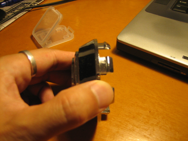

What do you mean by universal, the hole they clip into are different sizes on different wheels, do these adjust?
If they dont can you give me some idea of how big the hole has to be.
Also how far do they stick out, from the pic it almost looks like the centre cap off a 4wd.
