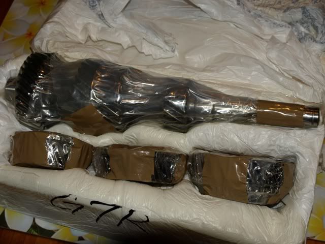

Well my mate back home opened up the goodies...
Here's the gear set...porn! Please excuse the frangipanis lol .

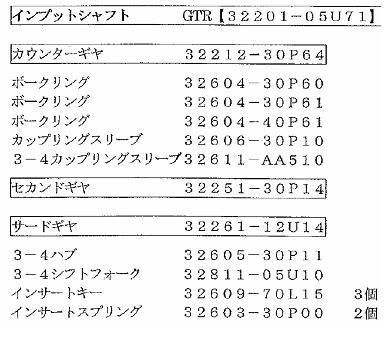

...and this is a parts list. Anyone hazard a guess as to what the non Part numbers mean and which parts go with what box???
