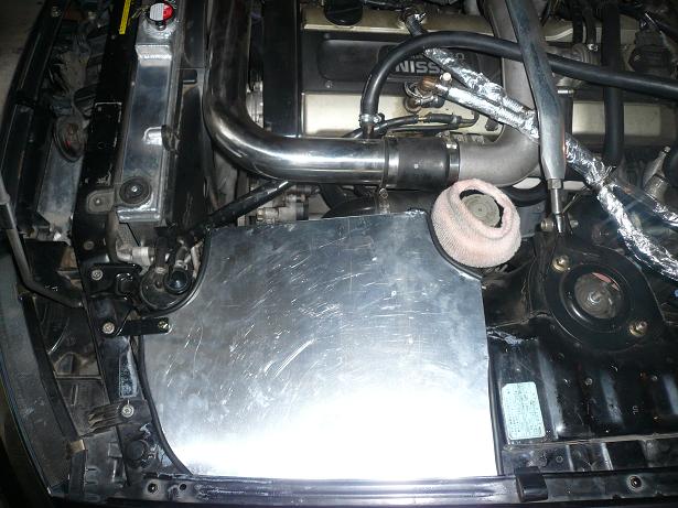

This is mine, from just jap.
the other one Im thinking of has the return pipe away from engine (opposite to mine)
and uses the stock intercooler pipes and holes near the airbox

The Stealth type runs the return pipe underneath the intercooler, no drilling or cutting required, i'd assume that it will breath better, as it has less bents and a shorter pipe then the original tube n fin type.
I've the tube n fin type, my return pipe runs across the above of the engine bay, and back to the throttle body, same as Evil's.
