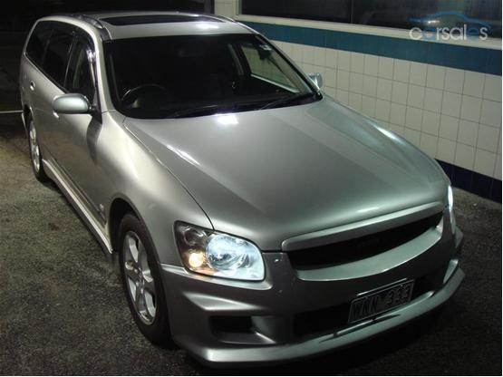

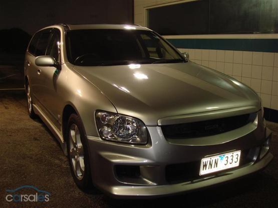

That front bar in made by Impul.
Try www.rmsmotorparts.com.au I am sure Henry could get it in for you.
or you could ask the guy that was selling that car as he was selling the car without it.

Sorry mate, whats that 'Dogong' mean?
I think that RBPOWA is pointing out the similarities between the Dogong's snout and the Impul front bar... The colour helps the comparison also!
Good call TJ!
