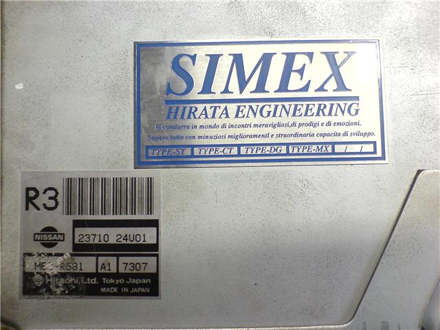

This ECU came with engine package ,NO in the running car , but dont know what was done to it , if it was chipped or anything else.
Anyone saw something like this before ?How can I work it out if something was cut off or something similar .
Can anyone help with some info before I will take it apart ?
Thanks

It's a stock ECU that's been chipped to optimise (in theory, at least) the fuel and/or ignition curves for, say, Jap 102 RON fuel. My GTR has a MINES chipped ECU and it runs fine on 98RON fuel, but my car is also fairly stock.
Anyway, it should run your engine fine as it is, but whether you keep it depends on your plans for the engine. If you plan mods then best get a PFC or something along those lines.

Contact these guys - Hirata Robotics
