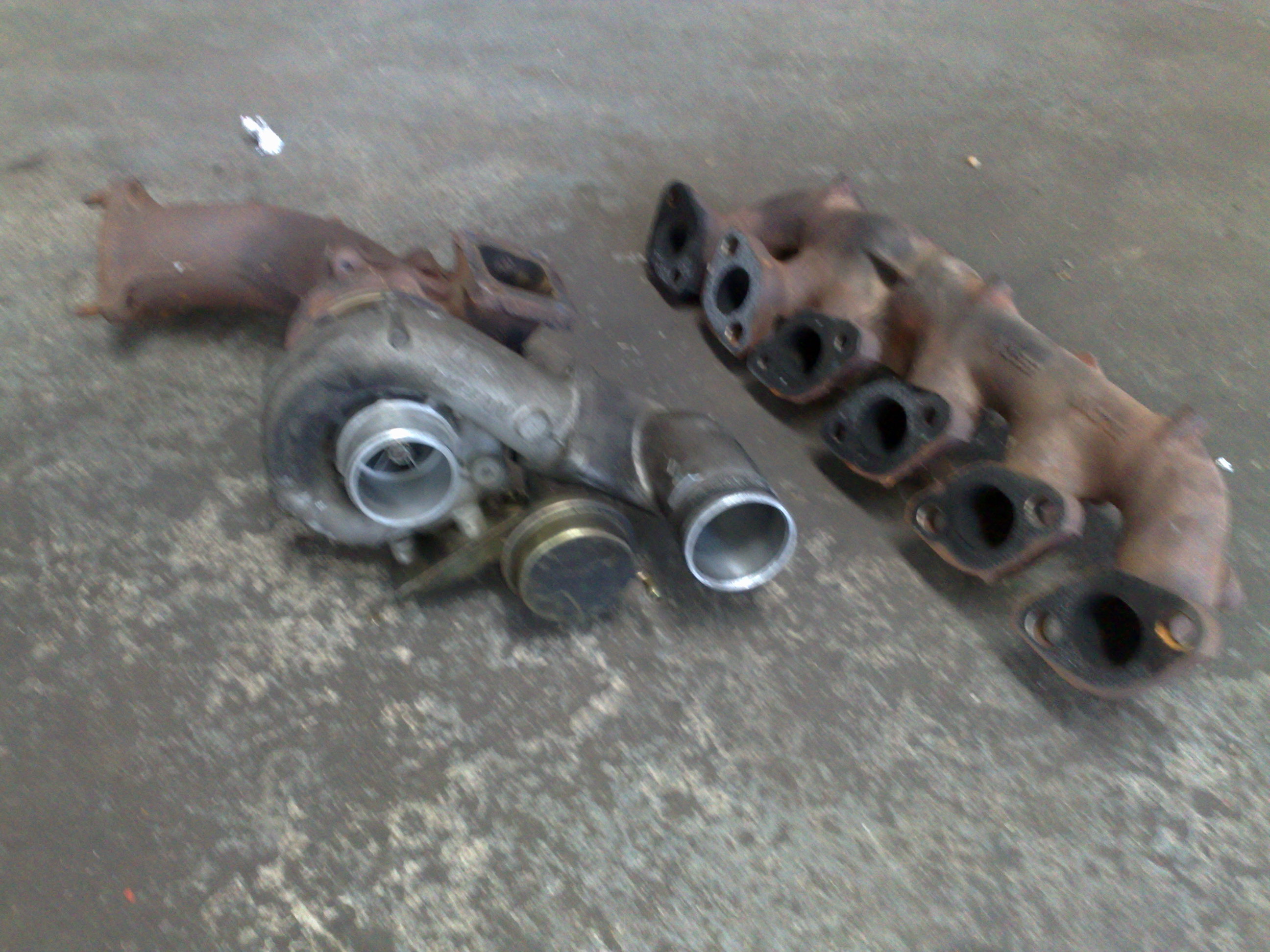

b]Item:standard rb25 turbo and manifold+dump pipe
Location: redlands area brisbane qld
Website: this one
Item Condition: used turbo has no shaft play all in good condition
Reason for Selling: upgrade
Price and Payment Conditions: $250
Pictures: yes
Contact Details: call, sms to 0433299013 or p.m
