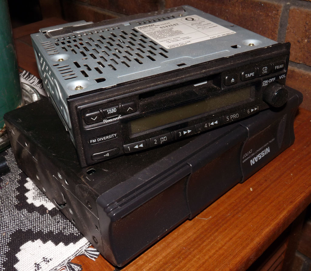

Hi all,
Got to give away my standard Clarion headunit/CD stacker controller and the 6-CD stacker unit out of the boot. These came standard on S2 with Xanavi setup. If you want them for a spare or something, all I ask is that you help pay the postage (a donation to me of $5 should be fine :thumbsup:)
DaveB
Here's a pic' of it anyway Chris, just curious what it is/what you were looking for...
Just to let people know again... at this stage it's gone (sold?) given away, thanks.

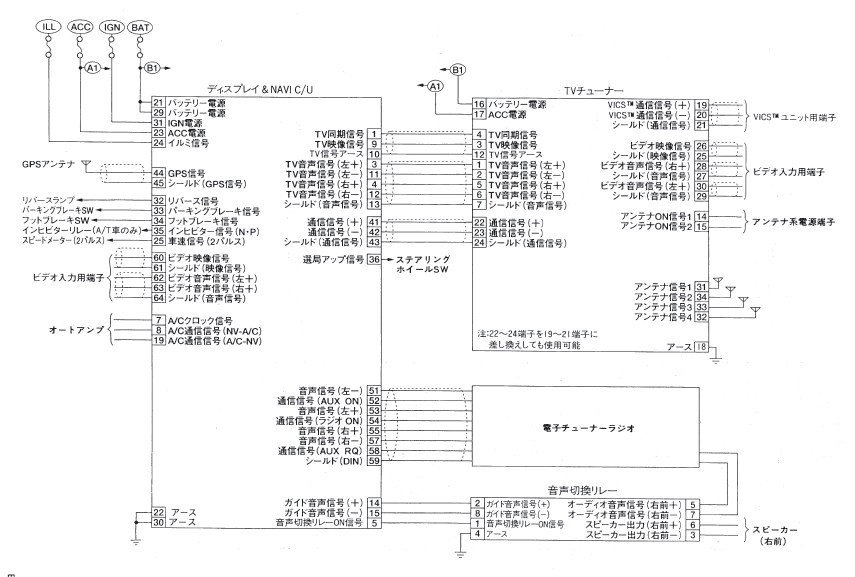

I had a xanavi unit, and to adapt it to the standard stereo wiring harness there was a short adapter which went from the standard wiring scheme (as per the post above) to separate/different plugs for the xanavi unit.
If you are after wiring diagrams for the xanavi you can try this pic'... mostly Japanese sorry :) (also I think it's series 1, but seems to be 99% the same...)
When you remove the headunit you've pretty much got to remove everything as per the headunit install post above. ***ONE DIFFERENCE WITH XANAVI*** is that there are two screws which hold the stereo surround to the mounting bracket that the headunit/LCD etc. fits in. So, you can't just pry off the surround as suggested in pics 4 and 5 of post #2.
Apart from that it is a really good guide. You'll know if you have a xanavi setup, because you've got 2-DIN-unit LCD touchscreen for your climate control, with a (albeit NTSC) TV tuner :D
