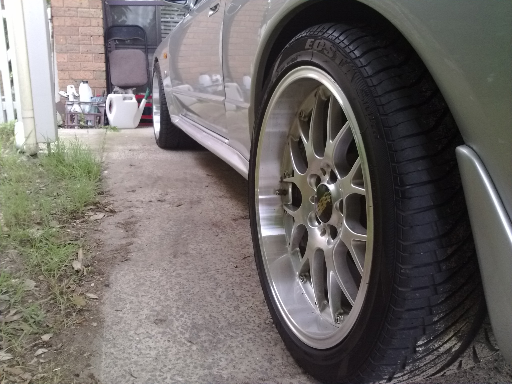

Bbs , Rs-gt 18x9.5 +20 With Near New Tyres
