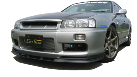

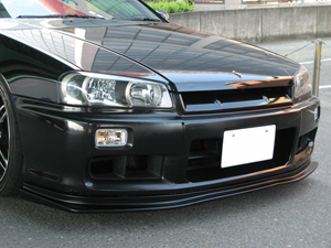

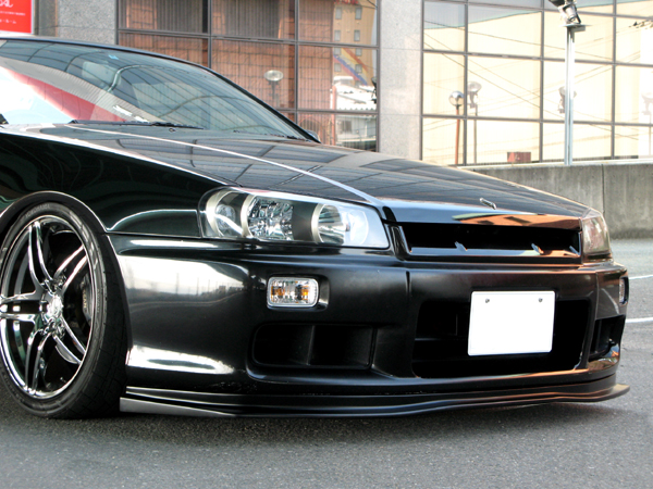

Like the other guy was reffering a lip on the front bar would look good, thats what im planning on doing later on.
Eastbear and Uras make some good ones, the last 2 photos are uras. The east bear lip is pretty expensive but viva garage in adelade make copies of both brands, does any body else know if anyone in melbourne makes copies of these lips?
