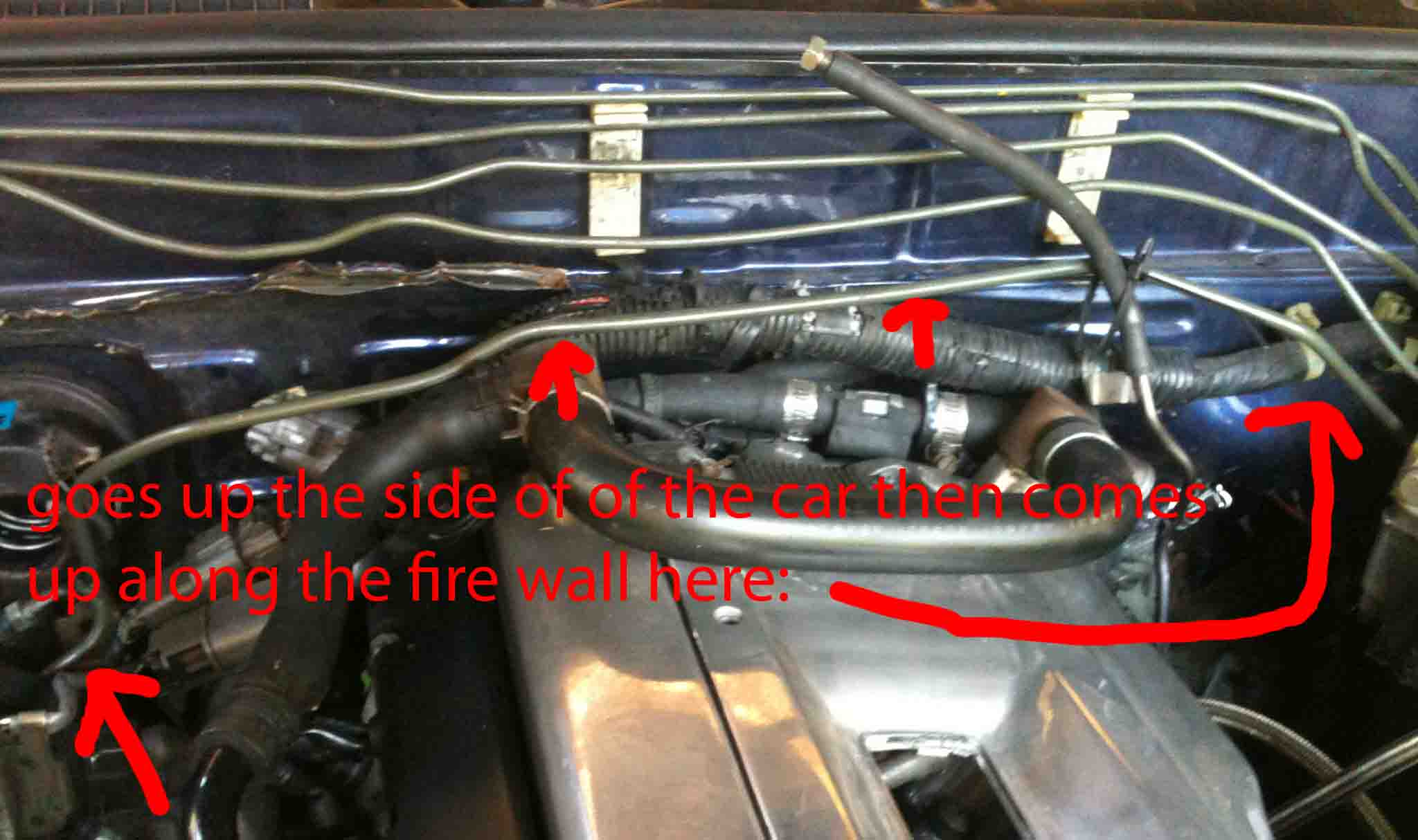

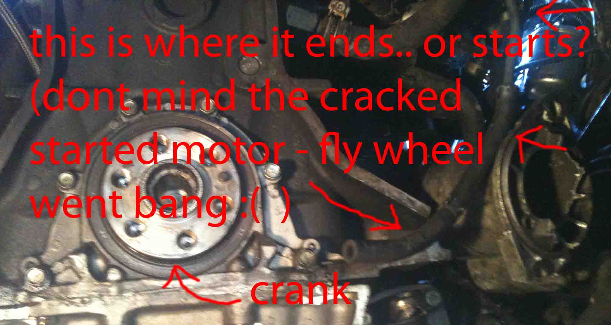

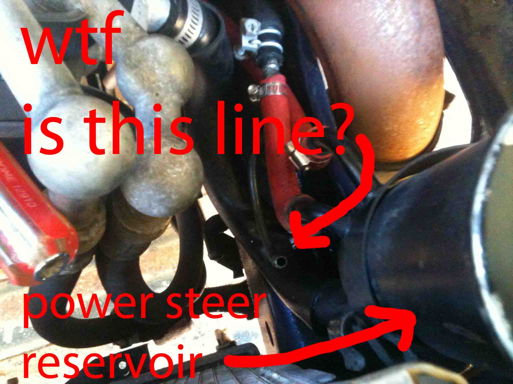

well yer it started exactly where the carbni canister line starts and ended down under the car on the right hand side of the engine (where the line is meant to go) so im 99% sure it was the last bit of remaining line for the carbin canister. thanks heaps for pointing me in the right direction mate!
