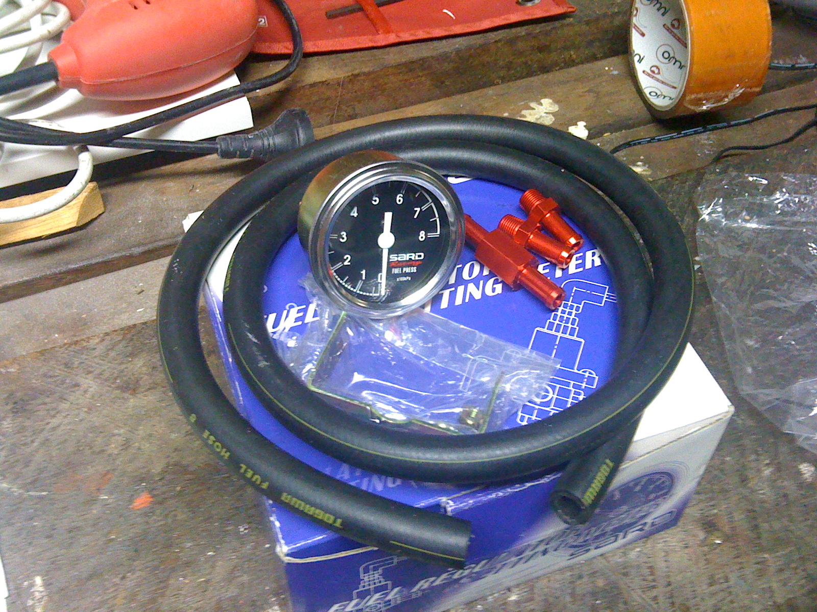

Hey mate, I have a set, one is slightly damaged but wont be noticable once installed. Shoot me a message if your still after them
I couldn't wait But, the black constant tension hose clamps were too thick and there wasn't enough clearance at the T/B and I couldn't get it to seat properly, so I had use a silver one there I also added some 3" silicone over the alloy bit that goes through to hole on the radiator support as it looked like it was sitting on the edge of the hole in the radiator support, I never noticed a rattle or anything, but there was a witness mark It is basicly done, and I can live with the silver hose clamp at the T/B, I will get a black clamp for the head vent though where it is attached to the bulkhead fitting It never stops...LOL, only issue now with the shock tower brace is it slightly touches the under bonnet liner now, if I leave it it will either wear some paint off the brace where it touches, or damage the liner, so I removed the liner to see what I have to work with, with the liner removed I have about 20mm of clearance, but sadly the middle part of the underside of the bonnet is only dusted with paint and looks crap, so I cannot have that, but.... as I have a roll of Carbuilders premium under bonnet insulation in the garage laying around that is only 5.5mm thick (we were going to use it on the boys Patrol, but he crashed the front of it a few months and it was written off, hence why he now drives my old Honda Accord Euro), I'll use the OEM liner as a template and get the Carbuilders stuff fitted up to cover that dusted paint up
