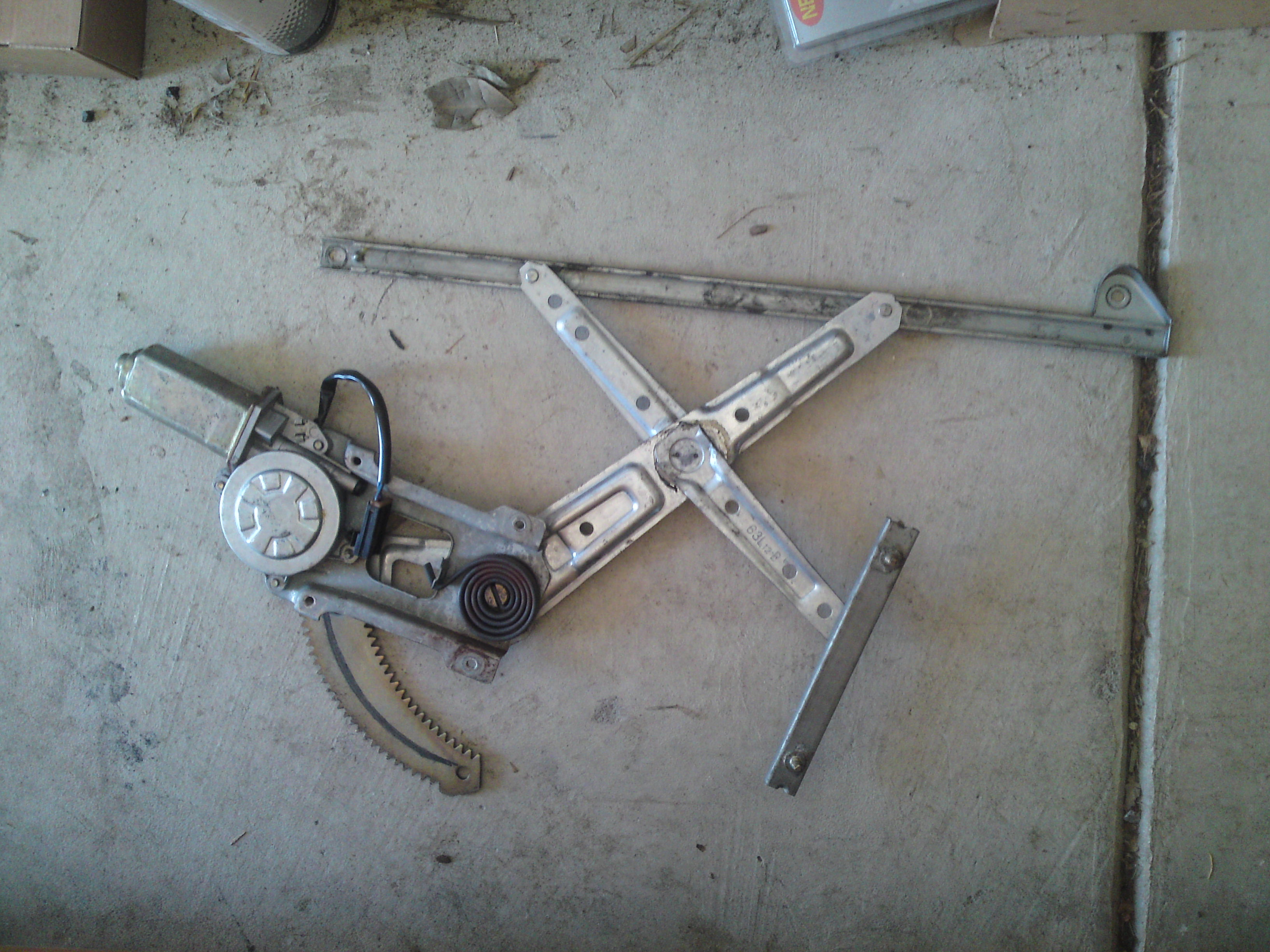

Hi Folks, I need to find a power window regulator for the driver side door of my R33 GTR. Aparently this assembly includes the motor and guides. Please help, I'm getting very sick of not being able to roll my window down! Thanks. Also, does it need to be from a GTR or will any regulator off an R33 do?

had the same issue a few weeks ago. You'll need the whole assembly which includes the motor
I used a GTST one and its working fine
The only thing was I couldnt install it myself.... too much of a mission... got an auto electrician to put it in cuz apparently you need some sort of special tool
Just put a WTB add on SAU and you'll get a few guys who have the assembly lying around.

Yeah, the motor works fine, but I guess it is all one unit- picture attachedpost-77126-0-14907600-1312266002_thumb.jpg
