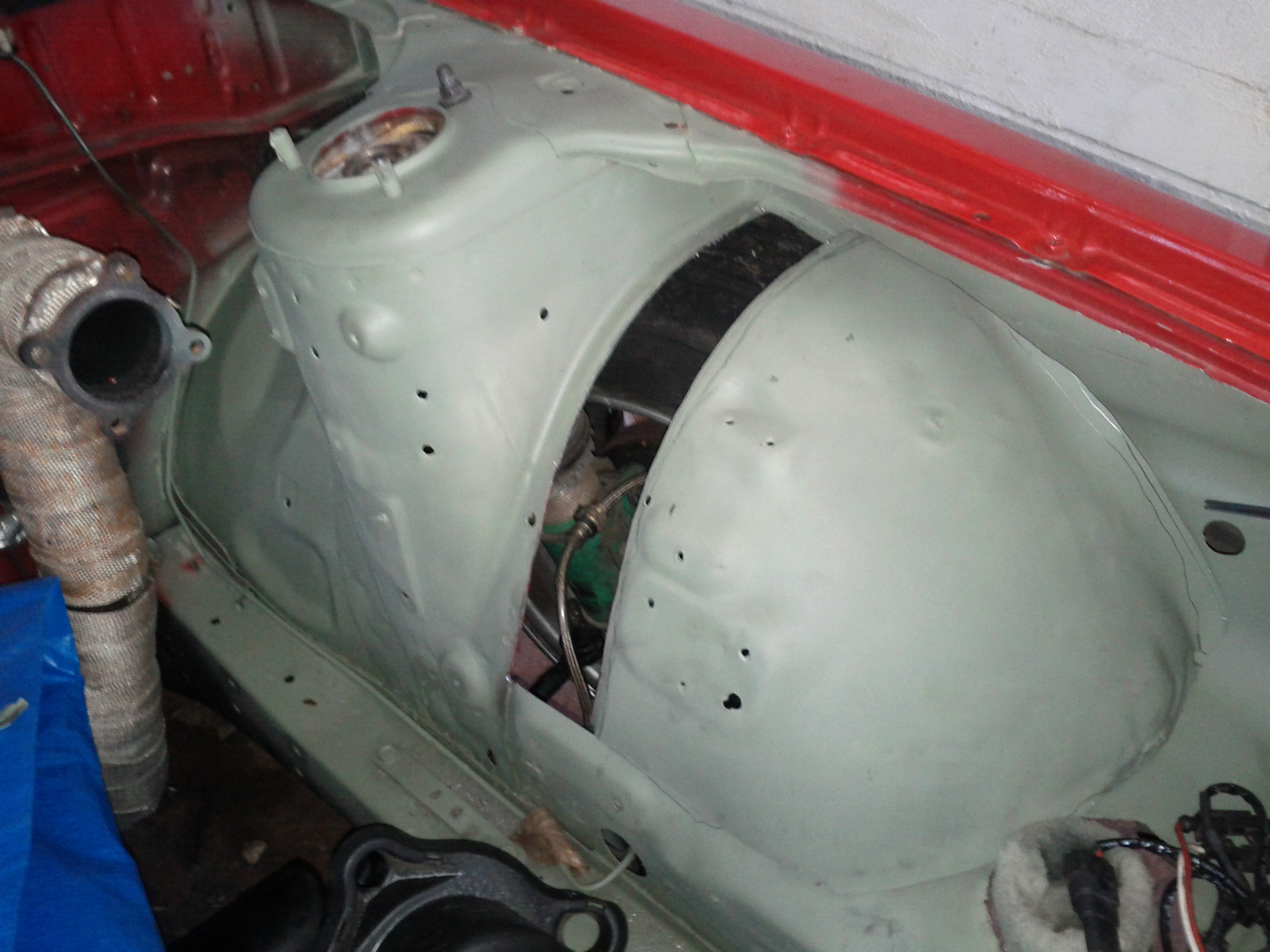

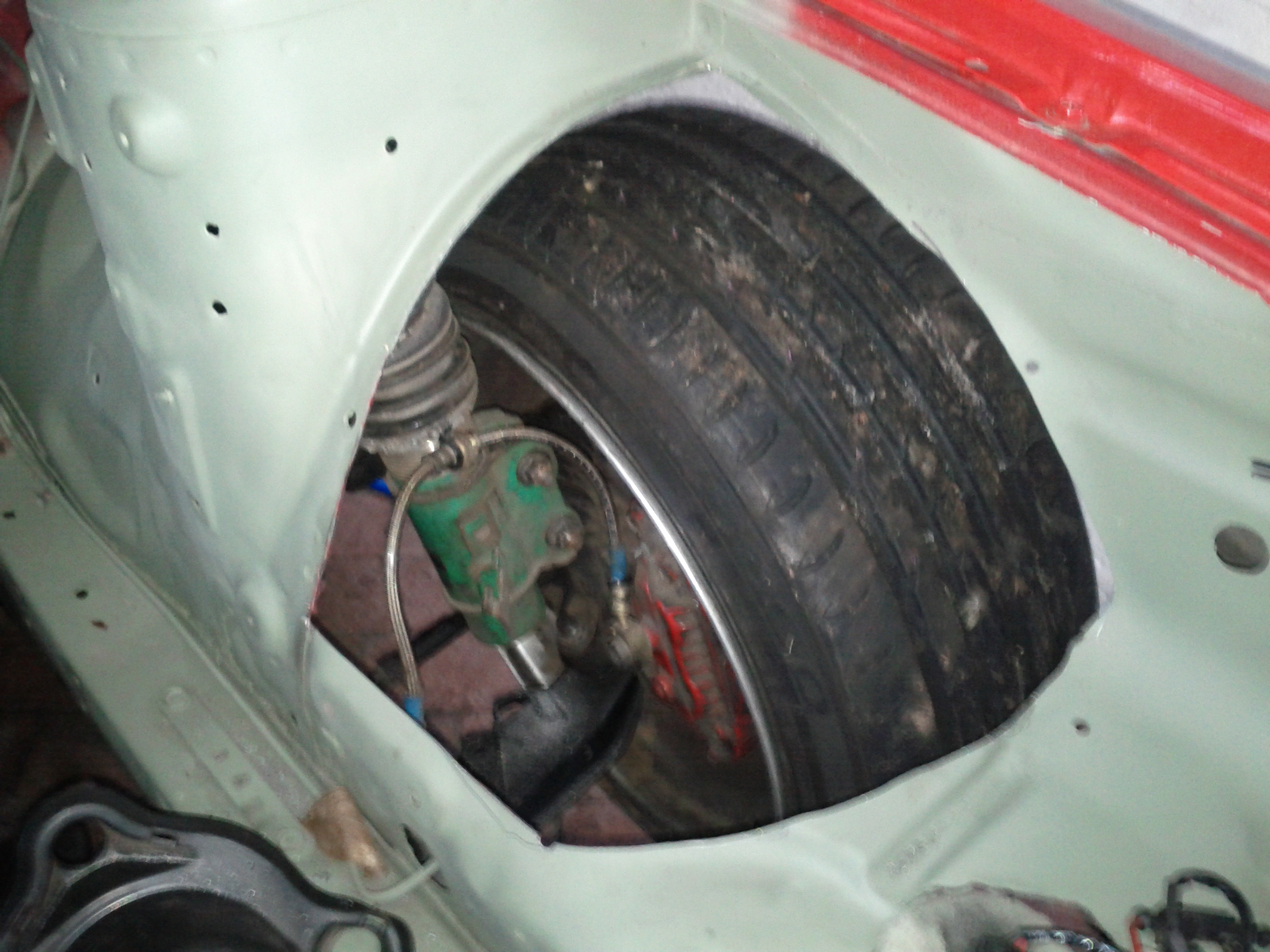

im having the same front clearence isues too!, heres wat im doin
fairly extreme i no, but got to the point were wheels would bind up, no amount of hammering could fix it.
wheels with still hit up top. just couldnt bring myself to fully tub it!
well worth it cos i will be able run more castor and more lock!

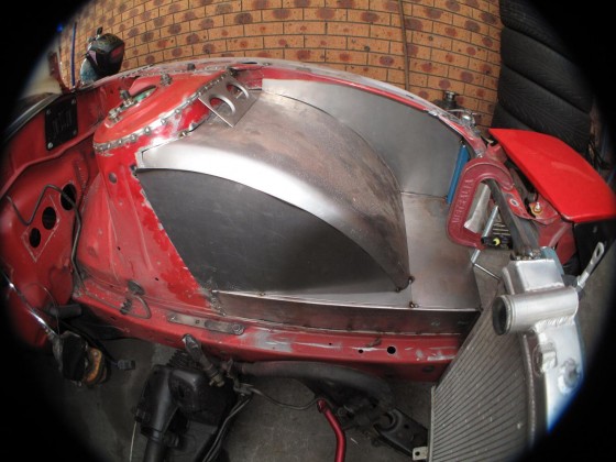

heres sum insperation from nigel!
hmmm yeah Im not that keen haha.
