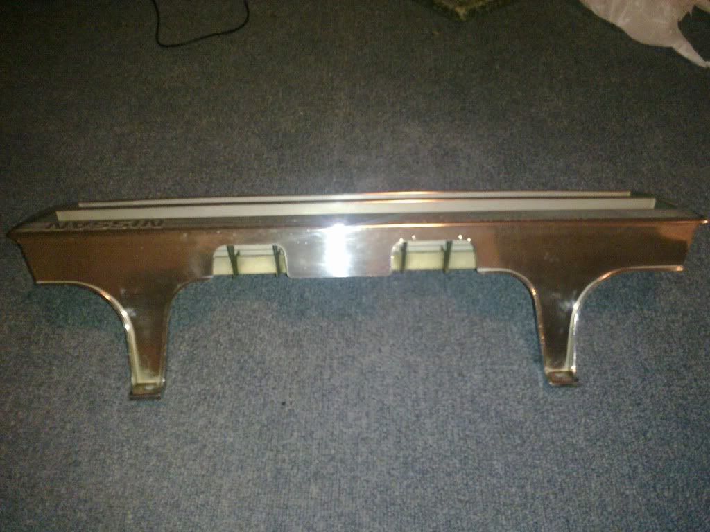

the top black section is bonded to the silver section with some form of rubber. I assume to isolated NVH from the box
Plan B? Get someone to machine up a metal bush/collar/whatever it needs to be to replace the rubber? I haven't had a close look at that part recently to have a proper feel for whether that's possible. But it might be easy.
I do not want to install a short shifter and the only other stock throw shifter I have seen is the Nismo "Rigid shifter" for $290 So plan A is to fill it with sikaflex to stiffen it up and hope for the best
