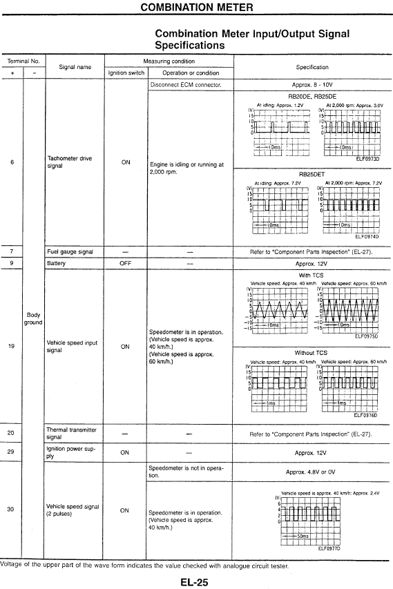

Gearbox sender is 2 wires to cluster. It is a +/- 1V AC sawtooth type signal. Should not be greatly different to that from the diff, except for pulse count per speed.
The ECU has nothing to do with it. The ECU and every other CU is a client of the speed signal generated in the cluster by the speedo head. That is a 0-5V PWM signal.
All this is in the R34 manual.

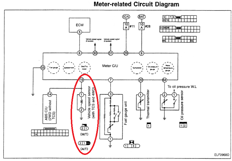

So there is one vehicle speed sensor input wire [#19]

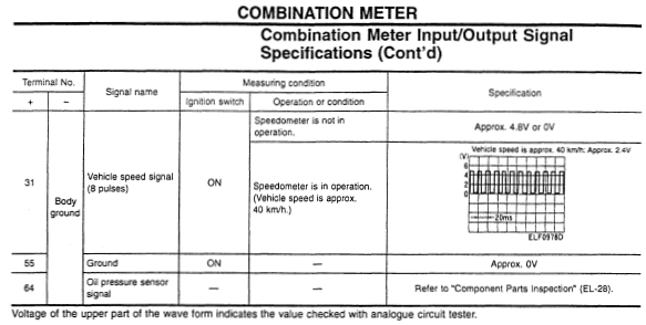

The 2 vss output wires are 2 pulse [#30] and 8 pulse. [#31]
Im guessing 2P is for manual transmission sensor and 8P is for auto final drive speed signal. It would be safe to assume whichever one I have, I should wire in the opposite for ground. I need to put a fuse on the ground side too by the looks of it.
No. I would presume not. I cannot see why there would be 2 different outputs based on what the input type was.
I would presume that the 2P output is used by some clients in the car, and the 8P would be used by other clients (think of the various CUs in the car, ECU, TCU, ABS, HICAS that want to know a speed signal).
The only input is pin 19 and the input needs to come to pin 19 from whichever speed sender is in the car.
Look at the whole wiring diagram to see where the dash's pins 30 & 31 go. But the answer won't be there. That's just for interest. Just wire up the gearbox speed sender to the dash input 19 in the same was as it was from the diff. There is no power involved. The +/-1V signal is GENERATED by the inductive sensor.
No. Don't mess with #30 and #31. They are outputs. They go to CUs that want to see a speed signal. That signal is generated in the dash. The input from the sensor has to go onto #19 (and because it is an AC signal, there really should be a 2nd wire for that connection - you shouldn't be able to use body earth).
This is why I need a wiring schematic, takes out all the guess work. If it doesn't go to a body ground I have no indication of where it does go in the fsm.
Are you indicating it goes to a ground thats not a body ground? Sorry I seem to be misinterpreting you quite a bit here.

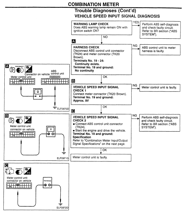

Hmm. Maybe I correct myself. Seems the service manual shows the speed sensor is grounded on one side.
The manual also has ALL the information you need to fault find this.
Wire it up like this.
And use this sort of thing to help you diagnose.
