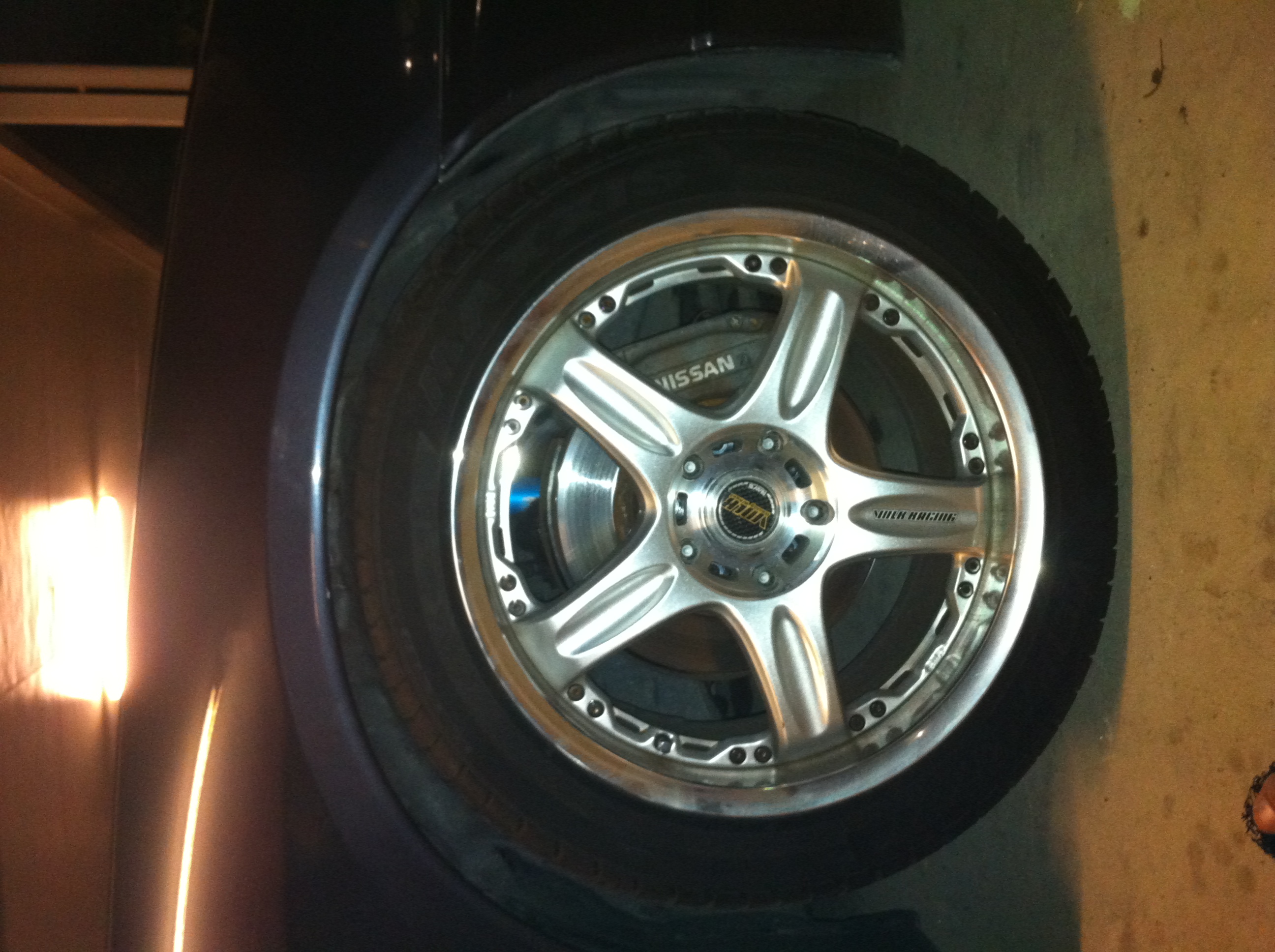

hey guys i have just put on 25mm neo tech spacers on my front wheels (235/40zr17's) and i have some question before i put spacers on my rear (255/40zr17)

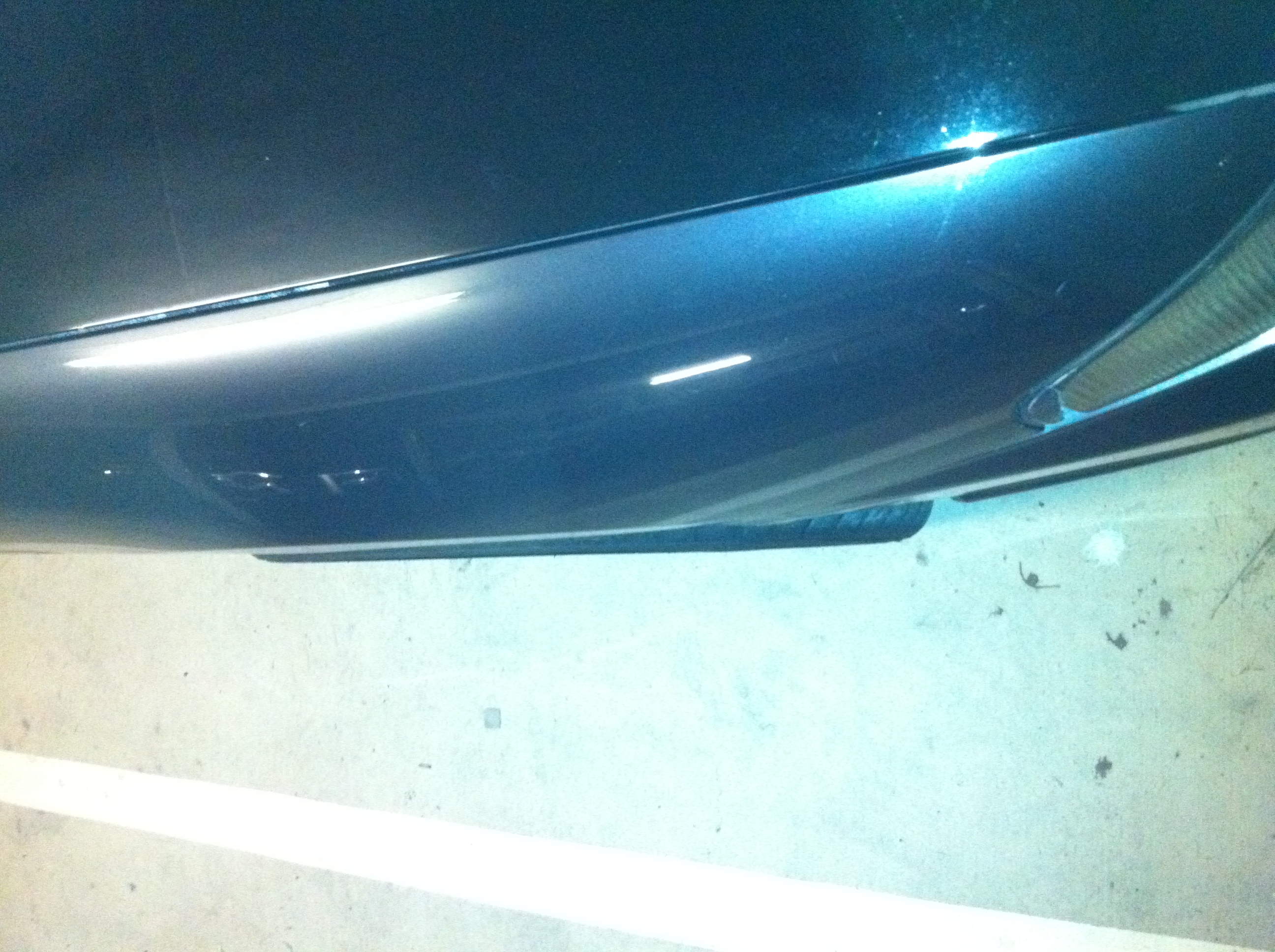

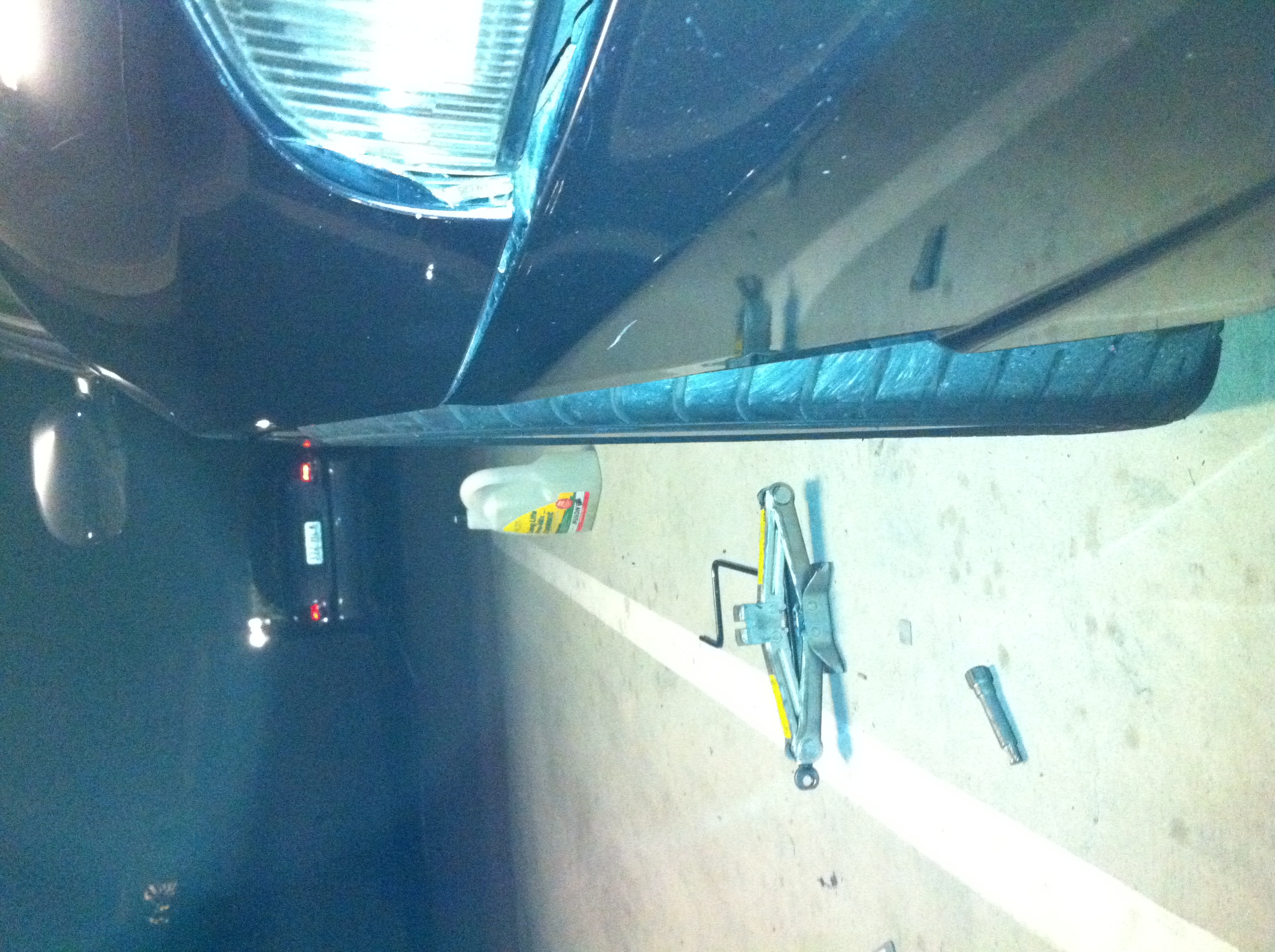

* the picture attached shows the front wheels with spacers and i just wanna know is this offset wrong and or defectable? (apart from obviously the spacers) i have heard that the tyres cant pass the gaurds true or false.

Spacers are a defect, those wheels are also a defect. You shouldn't post asking if something is a defect. If you question it, then it most likely is.
What offset are your back wheels? I've got 255 on my ass with 5mm spacers to clear my breaks. With 45 tyres, any more I'll be scrubbing the guard.
