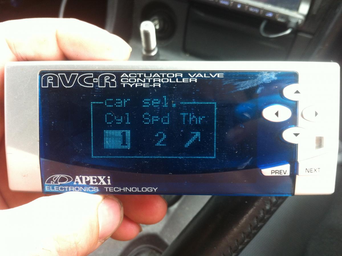

I Installed a apexi avcr boost controller in my r34gtt the other day. And the only way I can get it to work with the revs and speed is like this.
Cylinder 1. Speed 2.
im pretty sure it should be on on cylinder 6.
also when i rev it out to like 7000rpm the avcr will read 8500, 9000 but at idle the controller reads pretty much spot on.
Bad wiring ? Or faulty controller ?
any one else had this kind of issue ?

Cylinder is set to 6 for RBs and 4 for SRs
Speed is set at 2 for Nissan speed sensors
Throttle is set to point up, i.e. when pressed will trigger 5V or so
I would also check if there's a proper +12V feed going into it. I've seen dodgy installations where it's fed off the ECU harness for power.
https://www.sau.com.au/forums/topic/436602-avcr-trouble/#findComment-7159883
Under the steering column, so it's a constant +12V / +13.8 when running... as Joey said, just have a clean earth point using a spade terminal to the body of the car.
