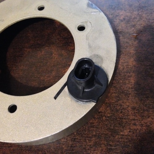

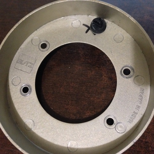

I recently replaced the pod filter on my 34 with an Apexi power intake and noticed that the previous owner fitted the intake temp sensor to the Blitz filter bracket bolting to the MAF.
Car runs fine with it unplugged and doesn't bring up the CEL but was wondering whether I should plug it back in and sit it loosely in the bay or just leave it unplugged.

This is the setup with the Blitz filter. Apexi filter is now fitted and included a bracket to mount to the body so is a little more cop friendly.

It's not silly Cal, it's more of an ambient air temp sensor. It provides a baseline ambient temp for the ECU in relation to ignition timing & knock reference. Doesn't matter how good your intercooler is, the cooled charge air temp will heat up alittle between the intercooler & cylinder. Mostly the air closest to the piping/manifold, not so much the air right in the centre of your flow. Depends on your porting.......

A proper intake temp sensor is best fitted on the intake manifold (like a gtr)
However I didnt know this was a stock sensor so makes sense I guess if it normally went in the side of the airbox. I thought someone had added this later (moving it from the intake manifold) hence my statement.

I always just tuck them close to the pod filter. They don't have to be in the intake. So long as its sensing the same air around the filter should be fine. Unless someone can tell me the filter changes the air temp lol.

this was on mine too previously hooked up to mfd, lol japanese people, they even just use water temp sensor instead the real intake temp sensor, but it worked, now ditched it.
as far as i know this is not factory, intake temp factory only exists in gtr and it should plugged to intercooler pipe or similar, so it's just japan!
