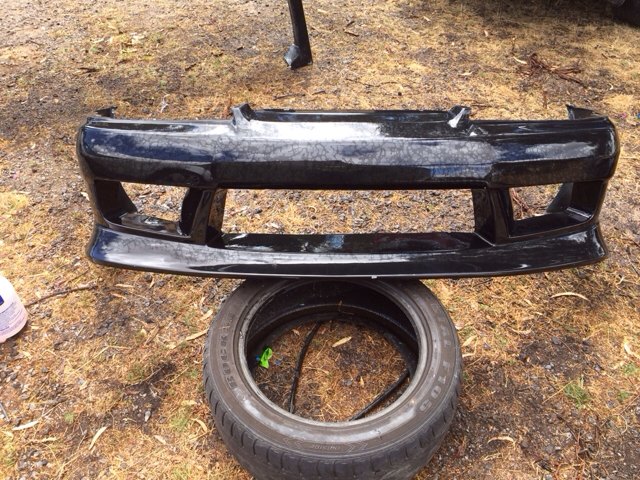

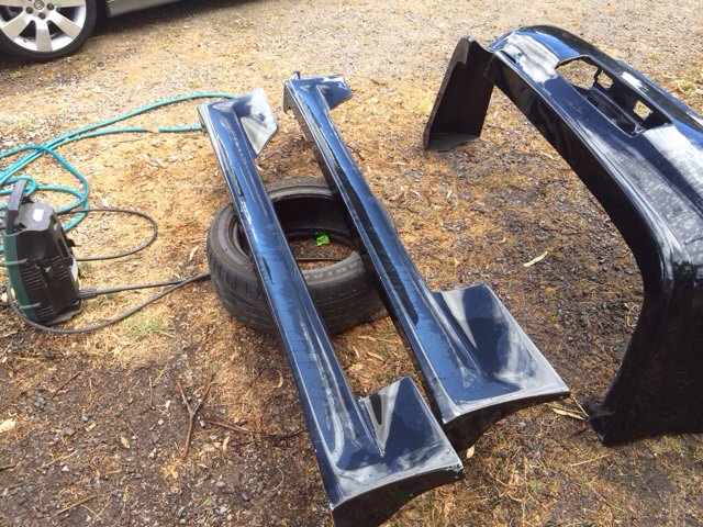

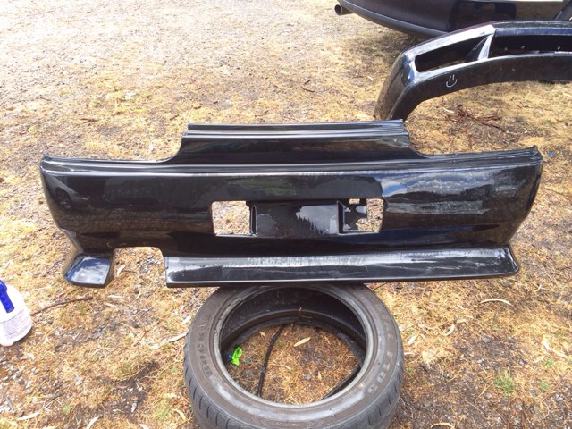

Vic: R32 Vertex Style Bodykit
By svenskalice · Posted
Thought i'd update on this. I was able to get in contact with Craig Lieberman and later on Darryl Alison (owner of Kaizo Industries). Darryl was able to help me verify that my car was in fact one of theirs and is helping me find more info on mine ! -
