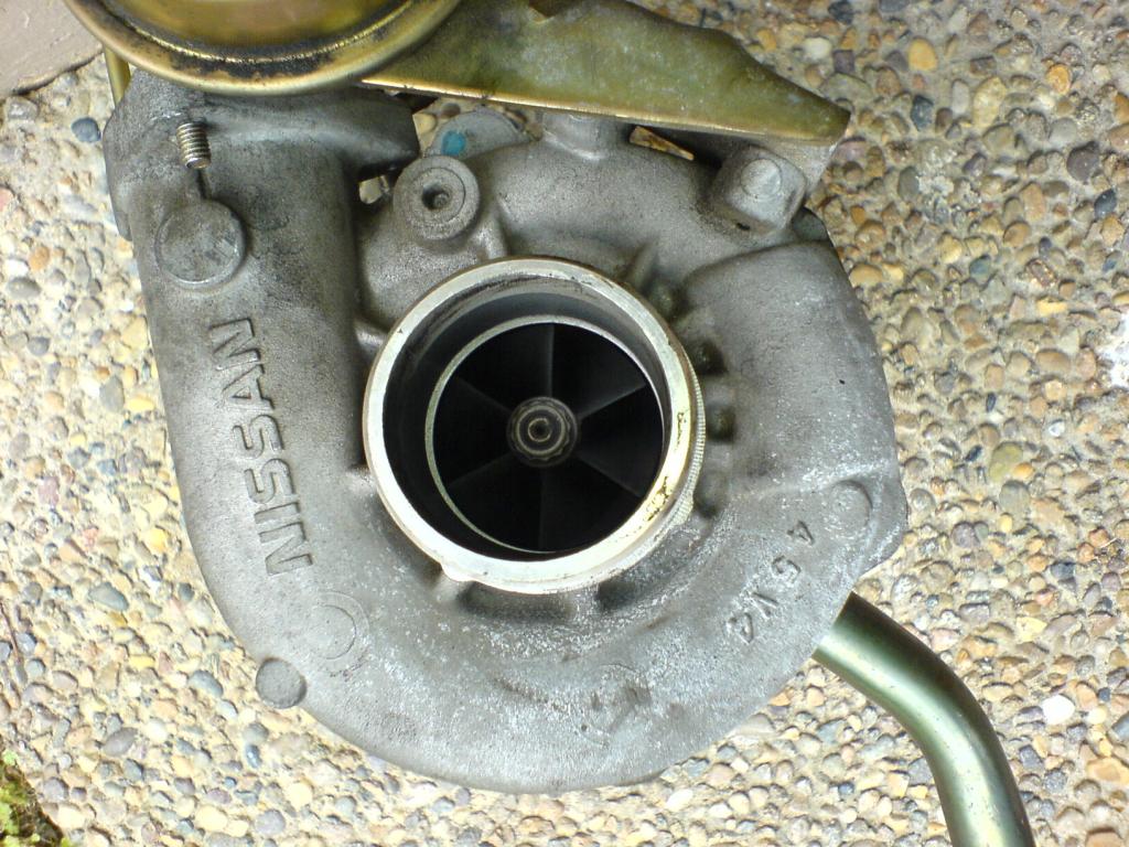

injectors were upgraded (1000cc), stock turbo high flowed, return flow infercooler and ecu nistuned before tuned -
