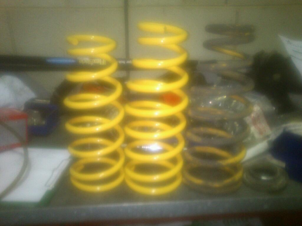

OK, so these are R32 springs, not R33. But shown are both GTSt (left) and GTR (right clean and dirty) front springs.
They are progressive. As are the rear ones that I didn't take any photos of. Kings, obviously enough from the colour.

I won't waste any time on this; call king springs and ask their tech dept about the spring rate of their r33 springs (as I did when looking at buying a set of their springs a while back). Couldn't remember 100% which was linear but yes it is fronts, thanks for posting pic up gtsboy.
I thought the softer part of the rear springs are meant to bind when installed with the weight of the car on them anyway? Effectively making the softer section helper springs to ensure that the springs stay captive at full droop since the rear shocks are so long
By the way. I load tested them. They're 5.something kg/mm but they're not linear.
load-of-bullshit tested them, more like. If you did actually test them then you fu*ked up the test; cos they're linear.
See how the diameter of the coils changes? Also changes the spring rate
nope. The diameter of the coils is irrelevant, it's how much they compress under load, eg a 6kg/mm spring compressing 1mm under 6kg of load. I know this to be fact, having specifically asked King Springs, MCA Suspension, BC Australia etc this question, when asking about any difference of spring rate between the wider springs found on stock suspension and the smaller diameter coils found on aftermarket coilovers. I'm surprised you didn't know that, being an engineer and all.
pretty much yep, more a dual-rate spring rather than a true 'progressive' where the coil spacing more evenly changes top to bottom. You can see this on the Tein website where they list the different spring rates for the same springs. But still classed as a progressive spring.
Varies with D cubed.
k = Gd4/[8nD3]
