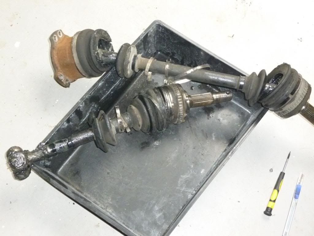

eventually it came time for the first WOF. Nothing too major, and nothing too unexpected. CV boots needed replacing, and some ball joints needed replacement. This is when i found how hard some of the parts are to find for the stagea. At the same time some parts are piss easy too because of Interchangeability.

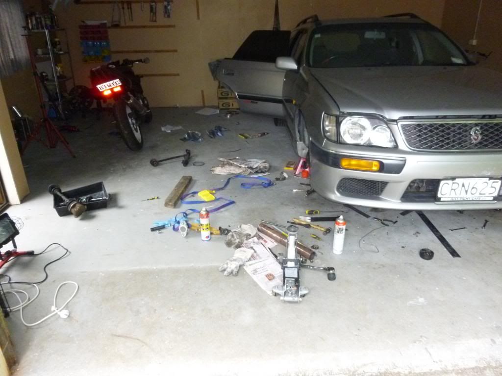

sometime after the wof, I ended up moving flats. Got our own place with a good size garage!

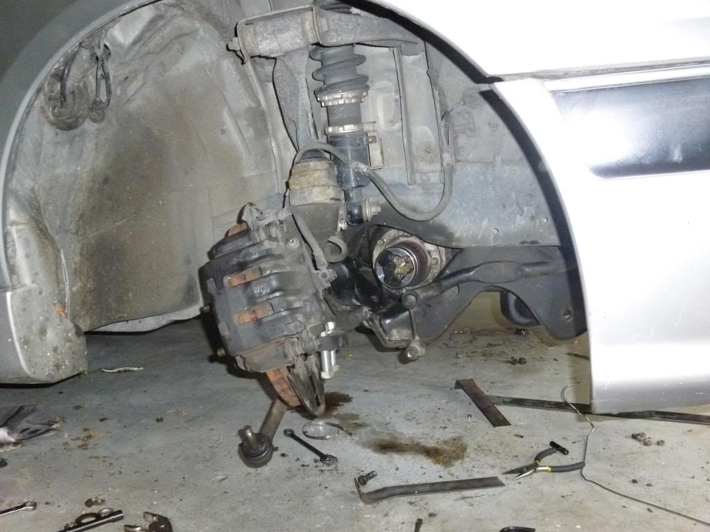

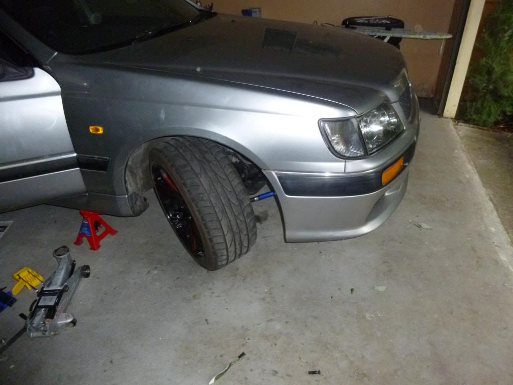

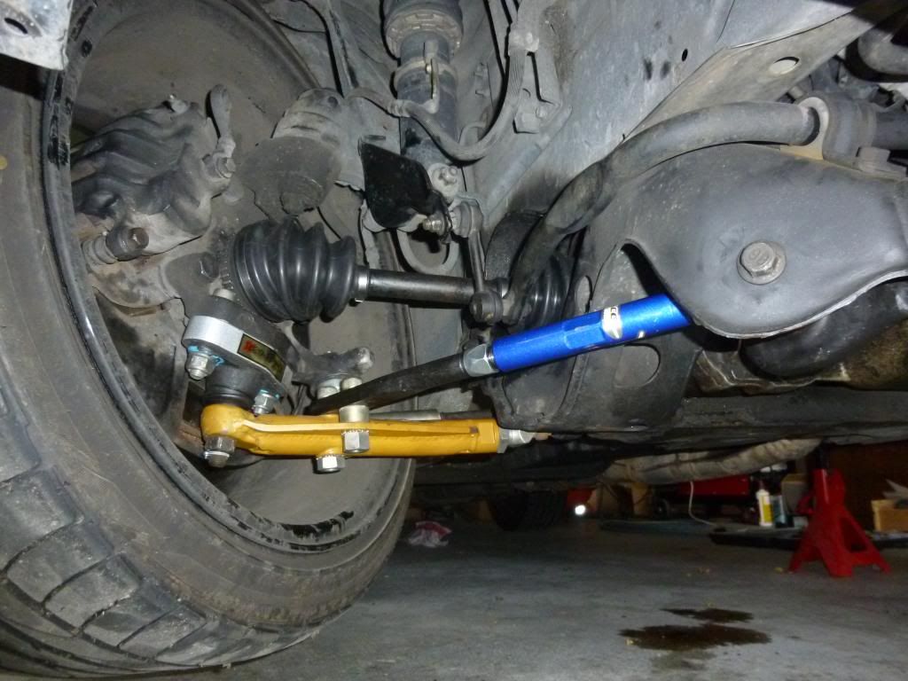

now with a new garage, it was a good time to work on the suspension. after gathering all the necessary bits and pieces, the work began

Are you going to push the front wheels out more to match the rear? Or using them as your camber adjustment? Looks like fun man.
yeah that garage was pretty fun! I just used the LCAs to adjust the camber. Was going to get adjustable UCAs to push them out but never got around to it.
