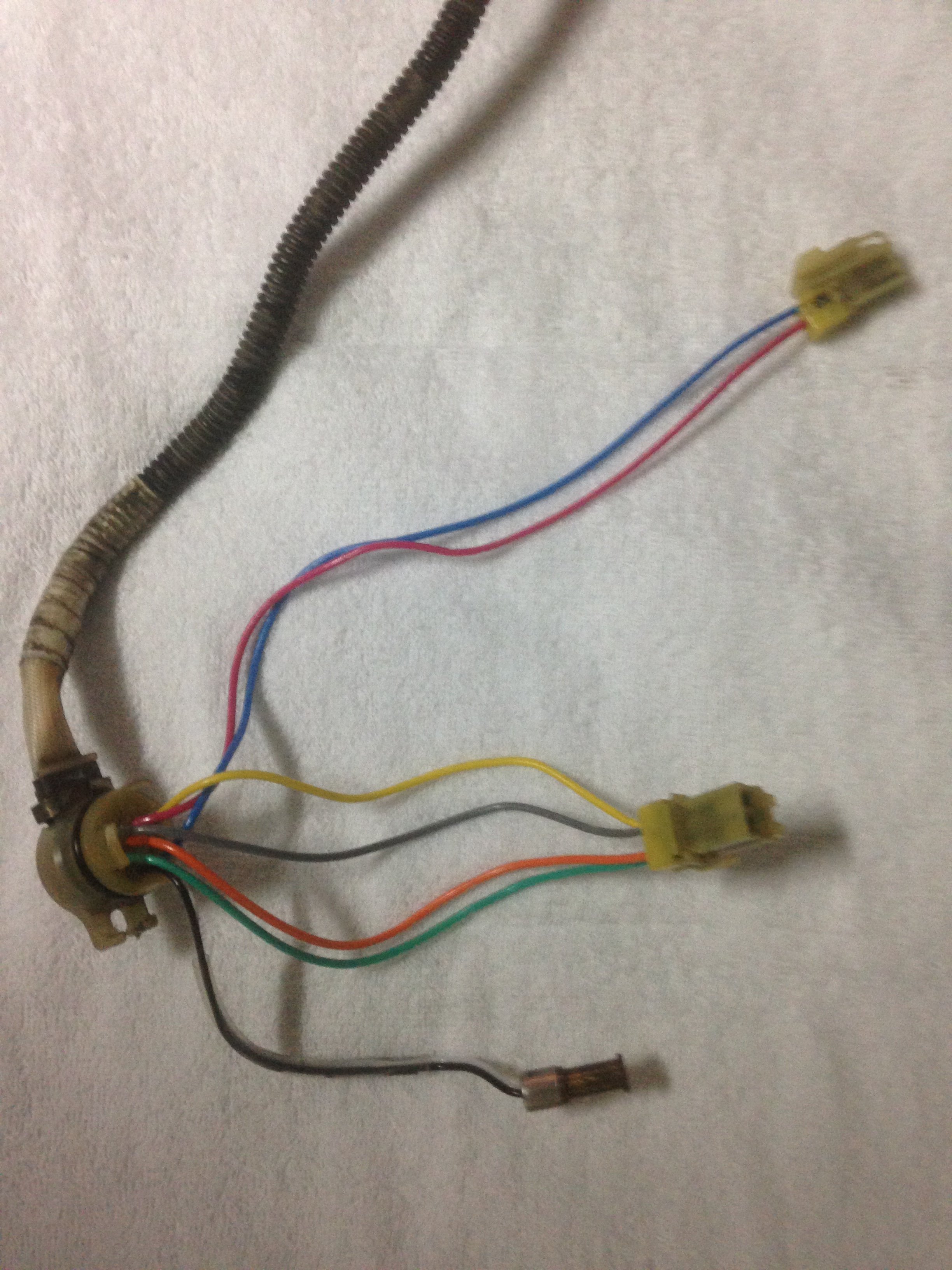

Hi guys and girls  I got a 93 r33 s1 I'v blown up the auto transmission I got a new one but they gave me a 95 s2 one of the plugs has got an extra wire going to it I think it's a eath but not sure does anyone no what it is? And can anyone tell me what colour s1 wires go to s2 wires?
Thanks in advance  advanceIMG_6206.thumb.JPG.529c5b6556d41c0058d5c8a5e10b9282.JPG    s1 ?
IMG_6205.thumb.JPG.a4efeffa3d2f83eb107535ab38d2e941.JPGs2 ?
For anyone trying to do this I figured it out  the s1 transmission has a 7 wire plug and the s2 has a 8 wire plug but where it plugs into the main harness in the engine bay that plug has 8 so you just have to run an extra wire from the engine bay plug to the spare s2 transmission wire
