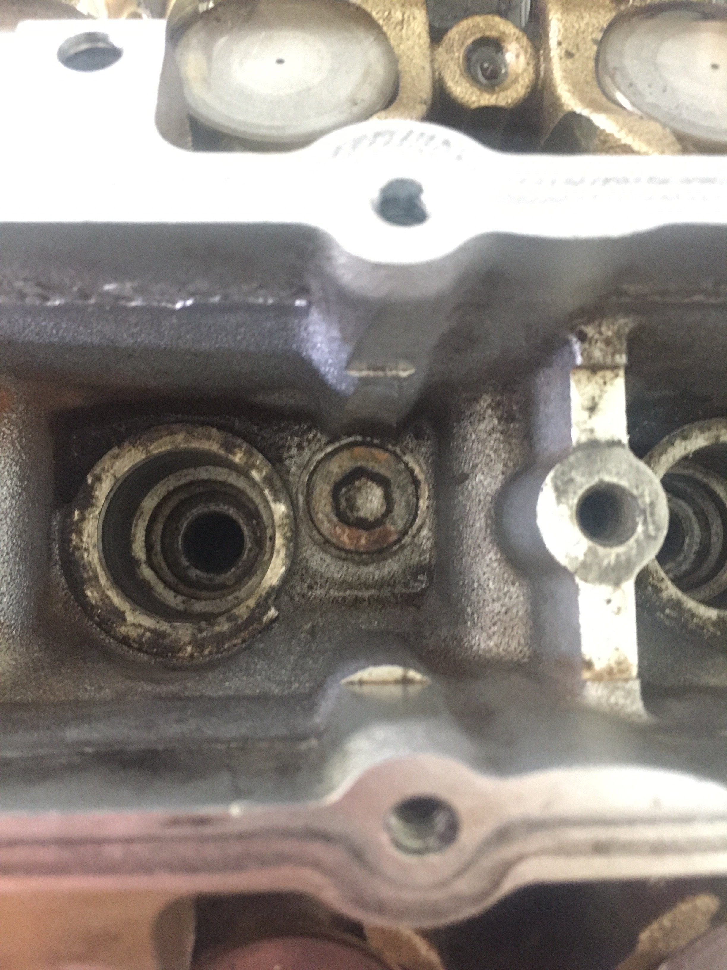

Pulling apart an rb25det and the 3 head studs in the middle are in there f**king good the rest were easy to get out,  I’ve managed to round the hex bit on one so it’s f**ked, tried welding a nut on but it’s too hard to work in the small space, tried putting in larger bits nothing’s worked. Is there any suggestions you guys have?
Edited by Shir
https://www.sau.com.au/forums/topic/476065-help-required/
They do not need to be removed. No engine ever has a bolt right in the middle of 2 cylinders in the thinnest part ,, that would be mental.
they are plugs.
you have missed the stupid little bolts hidden by the inlet manifold in the corners
https://www.sau.com.au/forums/topic/476065-help-required/#findComment-7898536
