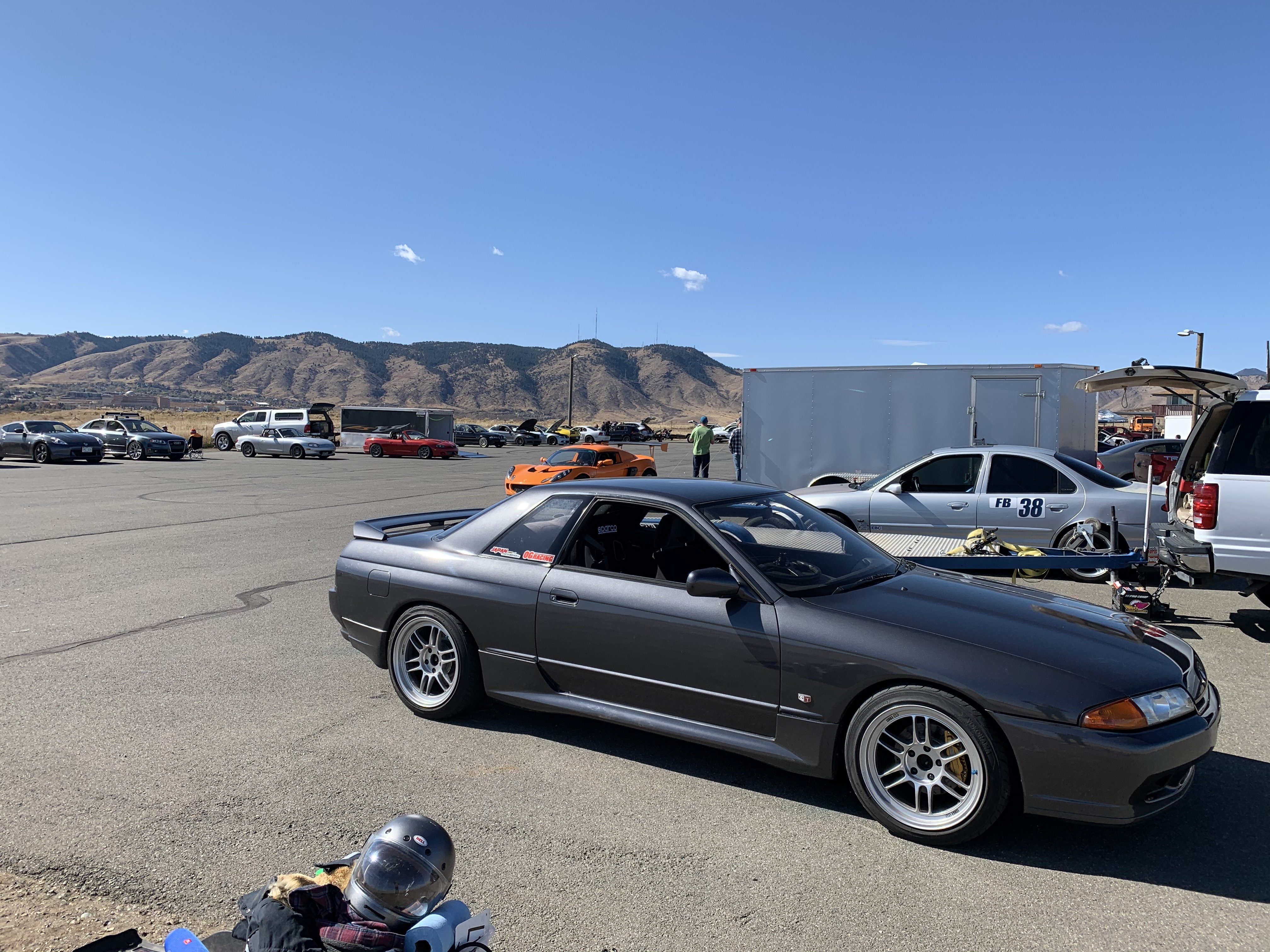

Pushed the car hard at a more technical track that also has a long straight. I noticed the clutch started to get a bit spongey feeling after about 3 30 min sessions. Didn't help it when the car cooled off so I'm wondering if I boiled over the fluid. Brakes felt very nice the whole time which I think surprises a lot of people being they're not some big fancy kit. DBA rotors with new z32 calipers, steel lines, and porterfield r4 race pads. Will lock the tires up with no fade consistently over a 1.5 hr stint. Haven't been able to get out longer than that but I'm sure they will get a bit tired after a couple hours. One thing that im working on is getting the car to drive like a naturally asperated bmw 6 cyl. The rb20 is right with them once it gets wound up, but before that it really struggles, which you really notice on corner exit. I have adjusted my driving style for the turbo car, which generally involves a tiny bit different apex point and getting on throttle a lot earlier. Even with this, its still a bit sluggish. And no, im not going to put a 25 in it and have it grenade after every 25 race hours, at least not yet hah. Other than that and the clutch issue, this thing has been a tank so far in testing. The next thing on the list is to cut the hood and fit a "gtr style" hood (bonnet) lip. Along with some standard hood vents. Also saw this trailer that I would love to have with that colour, quite a bit different than my pastel white hitch pull.
Have had the car out for a couple test days now. Everything seems to be going great. I've done a lot of data logging and have been reviewing it all. My friend and I made up a livery for the car too which came out pretty good. Obviously the car is still missing all of the aero elements that I'm looking to add as I'm currently playing around with some cfd for a rear airfoil. The empty space up front will be filled mostly with series sponsored logos and the number plates. Another big thing I'm really starting to notice is how over damped/under spring these coilovers i have now are (cusco), especially on slow corners. I've emailed MCA to see if I can work something out with them. If not ill have to get a set of custom penskes.
