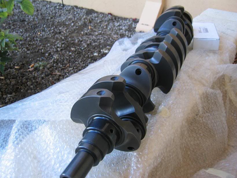

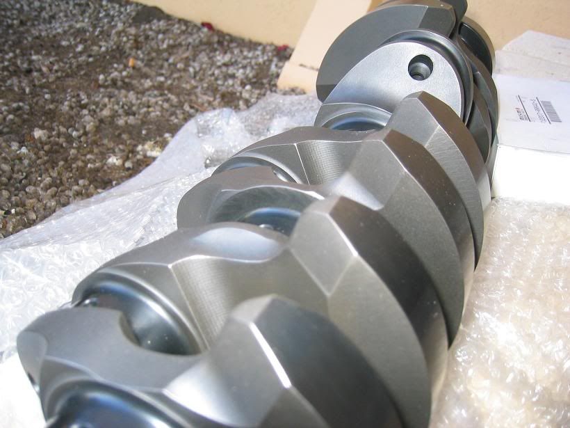

Hey guys, once again thanks for the interest, when i started this thread i thought the interest would centre aronud the gt-rs turbos, as these are always the centre of debate...
Again though please dont think im trying to say what i've done is ultimately better than using a brand new jap brand stroker crank, most of those cranks are a real nice bit of gear. However, value for money i may be able to compete on. For me it was just time as i have all the equipment at my disposal, but im in the midst of trying to figure if i can do this conversion at a cost that is both economical to me and to customers. To do this ill have to be well under the price of those kits. Im thinking that this conversion is good for people who've just trashed a crank through oil surge, and are looking at building a new bottom end, and need another crank anyway. One other thing to think on is while my crank is not fully counterweighted, this may be a good thing for a drag application, as fully counterweighted cranks are quite heavy. Lightweight cranks are always limited life but for drag work often this is not a worry

I put bigger injectors in and the car ended up making 406rwkw @ 18 pounds on pump fuel. Any more boost and it only picked up small amounts of kw and started to heat the air, not sure if the turbos are maxed out or if something in the induction setup is causing a restriction... not sure if my cooler is big enough. I've got another dyno sheet but its done in shoot 8 insted of shoot 6 so the torque figure is different due to the different ramp rate?? ( i dont know much about dynos). The power curve looks identical, just goes a few kw higher... To drive, the car is nice and broad and controllable in power delivery,pulls well from 3000 rpm and hard from 4500 through to 8500rpm...
Ive two more cranks almost ready to go, and more started for those that are interested. Please PM if you are intersested, so we can discuss options. It can be set up with std rods, or after market, 21mm or 22mm pins. My car will be on display at Adelaide auto salon, as will a 2.9l short engine. As usual any questions, comments or ideas just shoot

Im from Rhemac Motors, we are a performance engine machining shop. Prices for a built engine really would vary, depending on brands of parts used, std rods or aftermarket, how big a cams etc etc. PM me a phone number and i can call you. But ball park, crank and custom CP pistons, pins and rings $4000. By the time you did a whole engine and assembled it, start around $9000 - $10000 depending on what options, and then go from there with yet more options. Ill try take some pics on the weekend and post em up
