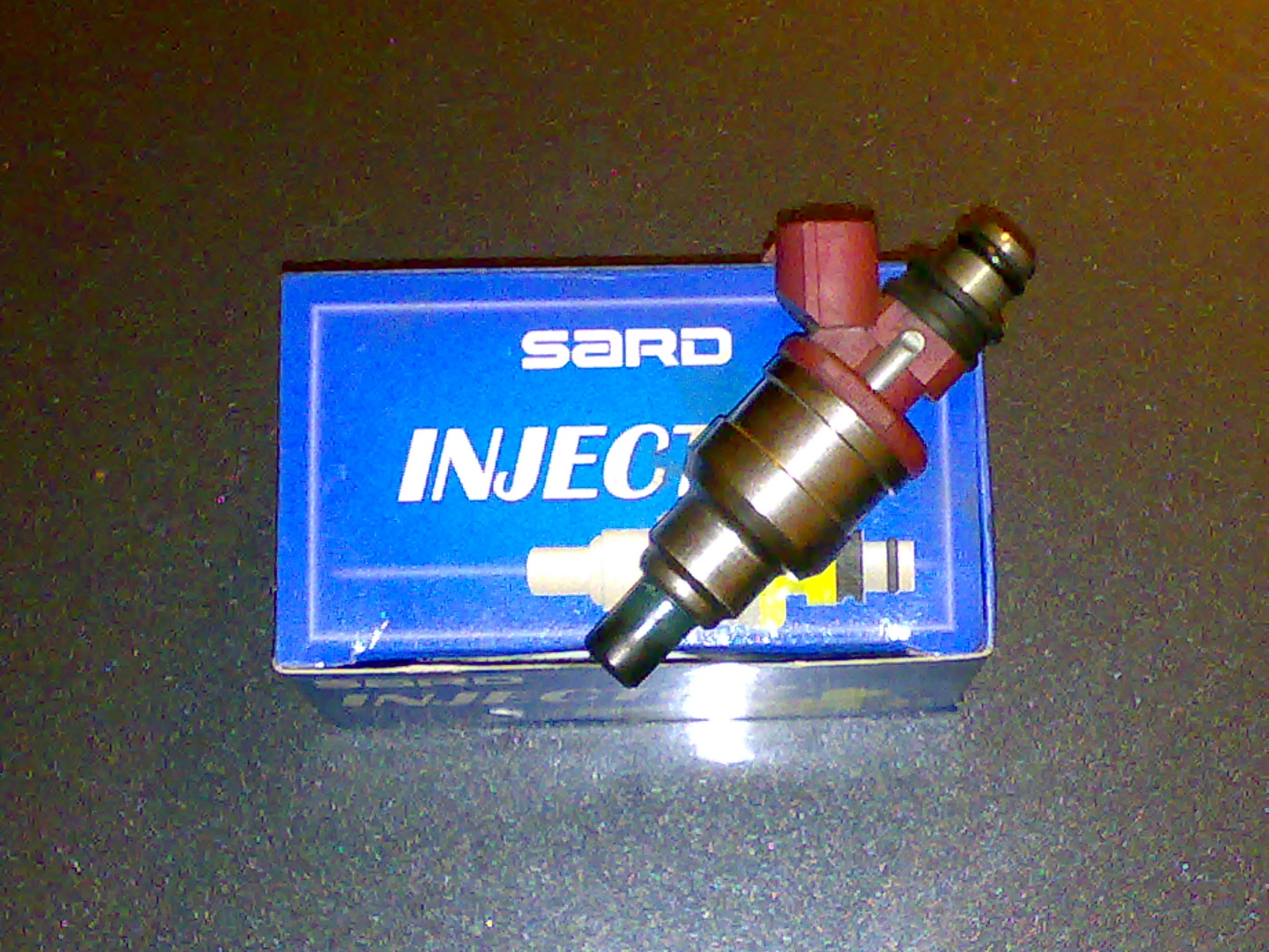

Set of 6 Sard 550cc injectors with plugs suit RB20, however they can be made to suit others with resistor pack.
Only done ~10K Km Good working order.
Great Price @ $350.
Also Q45 AFM, great condition = $300.
Located in Syd
