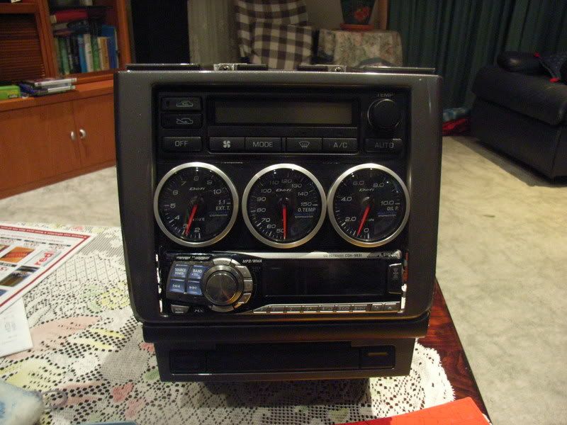

done some custom stuff today come up alright so heres the latest addition to my new baby haha
Nice car - although I'm not usually a fan of 33's, yours does look really nice.
Not a bad job with the gauges, too. I did mine on Thursday night. It's not perfect - they're not quite right when it comes to spacing between them - but I'm happy with it.
Mine's an offcut I got from a place in Castle Hill, in the complex where UAS used to be. It's polyethylene, and I think it's around about 10mm too. It was already black, so there was no need to paint or colur it in anyway, it already comes pretty close to matching the colour of the AirCon control panel.
It was pretty hard to get the spacing right, especially since we did it at home with a hole-saw which was 51mm, and the gauges are 52mm, so you have to file out the extra space to squeeze them in.
